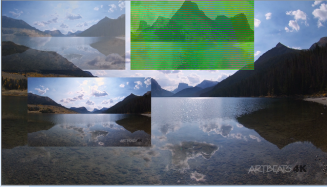

I am developing a sample application for overlaying four NV12 streams of different resolution. For this I am modifying simple_4_vpp_resize_denoise application present in mediasdk-tutorials-0.0.3 and I have followed the procedure as specified in https://software.intel.com/en-us/articles/video-composition-using-intel-media-sdk. I am using Intel(R) Core(TM) i7-4770R CPU @ 3.20GHz, which has Iris Pro Graphics 5200, Linux OS 3.10.0-229.1.2.39163.MSSr4.el7.centos.x86_64,  Media Server Studio Essentials 2015 R6 API version 1.16 for my development.
The application works fine if the input streams are of same resolution i.e. 1920x1080 with the below parameters:

and I get the below output:
Now I change stream3 to 960x540 and accordingly I modify my parameters also as below:

With this I get the output as:
I have done these changes in my application:

Please help me with this issue. Thanks in advance.
Mohnish_J_
736 Views
I resolved the issue. Input 2 stream parameters were not proper:
    inputStreams[2].CropW = DESTW_THREE;
    inputStreams[2].CropH = DESTH_THREE;
was to be replaced with
    inputStreams[2].CropW = CROPW_THREE;
    inputStreams[2].CropH = CROPH_THREE;
