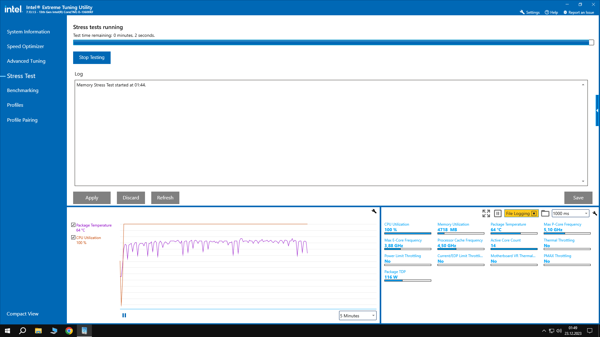

- Test your processor and attach the results of the following utilities, check the notes below each one of them:
Intel® Processor Diagnostic Tool
Note: Please attach the complete Screenshot or click on "File", select the "View Results File" option, save and attach the report.
Intel® Extreme Tuning Utility (Intel® XTU)
Note: Click on the "Stress Test" tab and "Start Testing" and then, attach a complete screenshot. Please perform all the tests possible.
Also, I noticed that your memory speed (3600 MHz) is outside the supported memory speed (DDR4 3200 MHz) as per the processor specifications. Lower the memory speed to a supported memory frequency or within specifications to avoid instability in the system. After this change, please attach a new Intel SSU report.

@Jocelyn_Intel Thank you for your reply.
1. Yes, and this includes games or drivers.
2. I tried, but I saw that they did not provide support on their website, so I could not contact them. So I contacted Epic Games.
Epic Games suggested me to use codes such as sfc /scannow or DISM. I have been using this type of repair for years.
If I'm not mistaken, XMP was developed by Intel, which is a strange situation. I turned off XMP and ran the RAM test with default settings. I didn't think about overclocking my processor or GPU.
