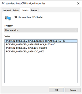

Hello.
Trying to find a suitable driver for this device (please refer to image below):
PCI\VEN_8086&DEV_9A36&SUBSYS_8870103C&REV_05

The specific device ID 9A36 is not included in the supported device IDs.
Checking the last character after number 3, we have: 31, 33, 35, 37, 3b, 3d, 3f
Question: Is there any particular reason for not supporting this Tager Lake H device?
Thanks in advance.

You should be installing the Chipset Device Software package provided by your motherboard manufacturer. It should resolve all chipset and supported processor devices included in your system.

Thank you for replying.
I searched major manufacturers, yet none of them provides the driver in question. Only standard Intel driver packages are available.
In such scenario, we are simply left with the generic Microsoft driver.
