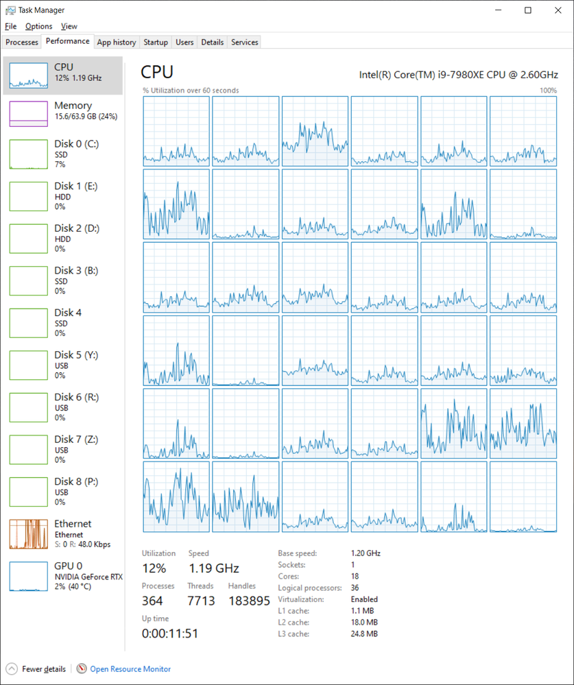

I have been stuck at 1.2 for a few days, I have updated bios and all the usual stuff, does anyone have any ideas out of the ordinary I can try?

issue is brand new
it was correct before
I have loaded bios to default
I have a brand new motherboard and new paste on it with a fresh install of win10home
its an Alienware area 51 R5 prebuilt
I have reported this issue to Alienware and they have no idea what to do after all the steps we went through to troubleshoot it, nothing worked
the issue started after I did a fresh install of the dell windows 10 media creation tool, then I tried to do a normal one and it was still happening, stress tests don't force it above 1.2 nothing does
