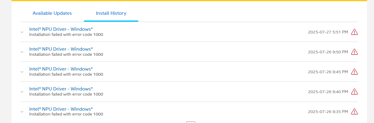

A few days ago I tried installing the newest NPU driver for my pc, and when the installation was complete, the installer said it was successful, but after I restarted my PC and reopened Intel Driver and Support Assistant, it says error code 1000 and that the installation has failed.
My PC specs are
Intel(R) Core(TM) Ultra 7 265KF
Nvidia GeForce RTX 5080
Windows 11 Pro 64 Bit
32 GB RAM
I am using the Edge Browser, and all my adblocker addons are disabled.
I am using the built in windows security, and there are no indications that it has blocked anything.
Intel Driver and Support Assistant is version 25.3.24.7

I do not know what happened, or if something changed, but when I opened the Intel Driver and Support Assistant today, it said I had no more updates necessary, and that the driver was installed correctly. No idea what changed, but I do not have any more issues :/. Very odd. I will keep this thread bookmarked in case I have any issues in the future. Odd.

Hello FeistySnacks,
To get a better understanding of the issue and be able to provide an effective recommendation, please provide the missing key information here:
  1. Do you have any proxy settings?
  2. Do have any pending Windows Update?
Additionally, I highly appreciate you sharing your system configuration so I can fully check and provide you with an accurate fix. This could be possible by downloading the Intel® System Support Utility for Windows* software. When the download is complete, launch SSU.exe.
  • Click Scan.
  • Click Save. *Attach the SSU log file as you reply.

I have no proxy settings setup
And my pc is up to date; no windows updates are pending.
Attached are the SSU scan results.

Hello FeistySnacks,
Please proceed with the following steps from this article link below, and let me know how it goes:
How To Install or Update the Intel® NPU Driver

The Intel NPU driver and the latest Intel Arc & Iris Xe Graphics drivers all install properly.  I would recommend that Intel modify or update the "Driver & Support Assistant" app and add a button to clear the Install history. The install history is showing failed installations of older drivers alongside a yellow triangle icons, which conflicts with the heading "Your Intel drivers and software are up to date."  This is confusing people as the newer drivers are working properly. You can remove the install history manually by following the instructions given by Copilot
a. running Win+R -> services.msc -> stop Intel Driver & Support Assistant
b. cd C:\ProgramData\Intel\DSA\Data
c. delete history file named install-history.json file
d. restart  Intel Driver & Support Assistant
e. relaunch the Tray app
A much better solution would be add a button to clear, or maybe hide,  the install history after a successful install of newer drivers - or the reinstall of a driver that then works properly.
