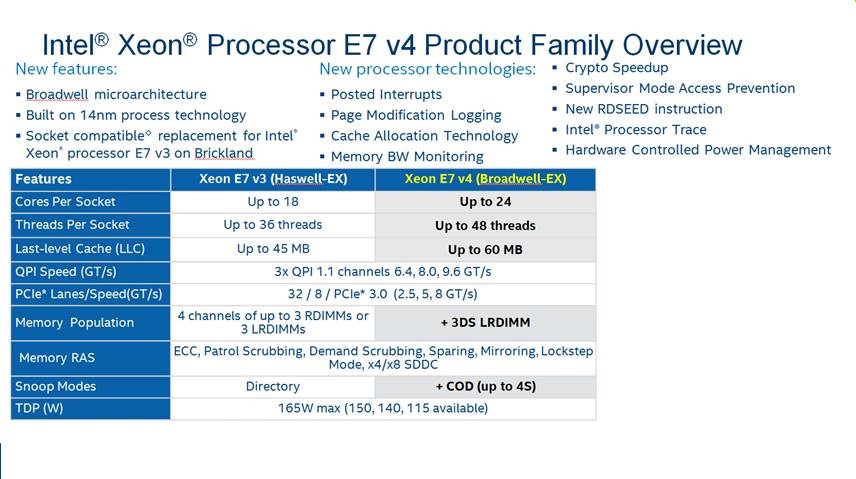

Ronny_G_Intel
3,266 Views
Hi younghyun,
Please refer to the following chart, it looks like CoD (cluster on die) is only supported on Intel® Xeon® Processor E7 v4 Product Family.
E7 v4 supports up to 4 sockets.
I hope this helps,
Ronny G
ycho8
3,266 Views
Dear Ronny G,
Thank you for your answer.
It helps me to understand current CoD supports for Intel NUMA families.
Younghyun
