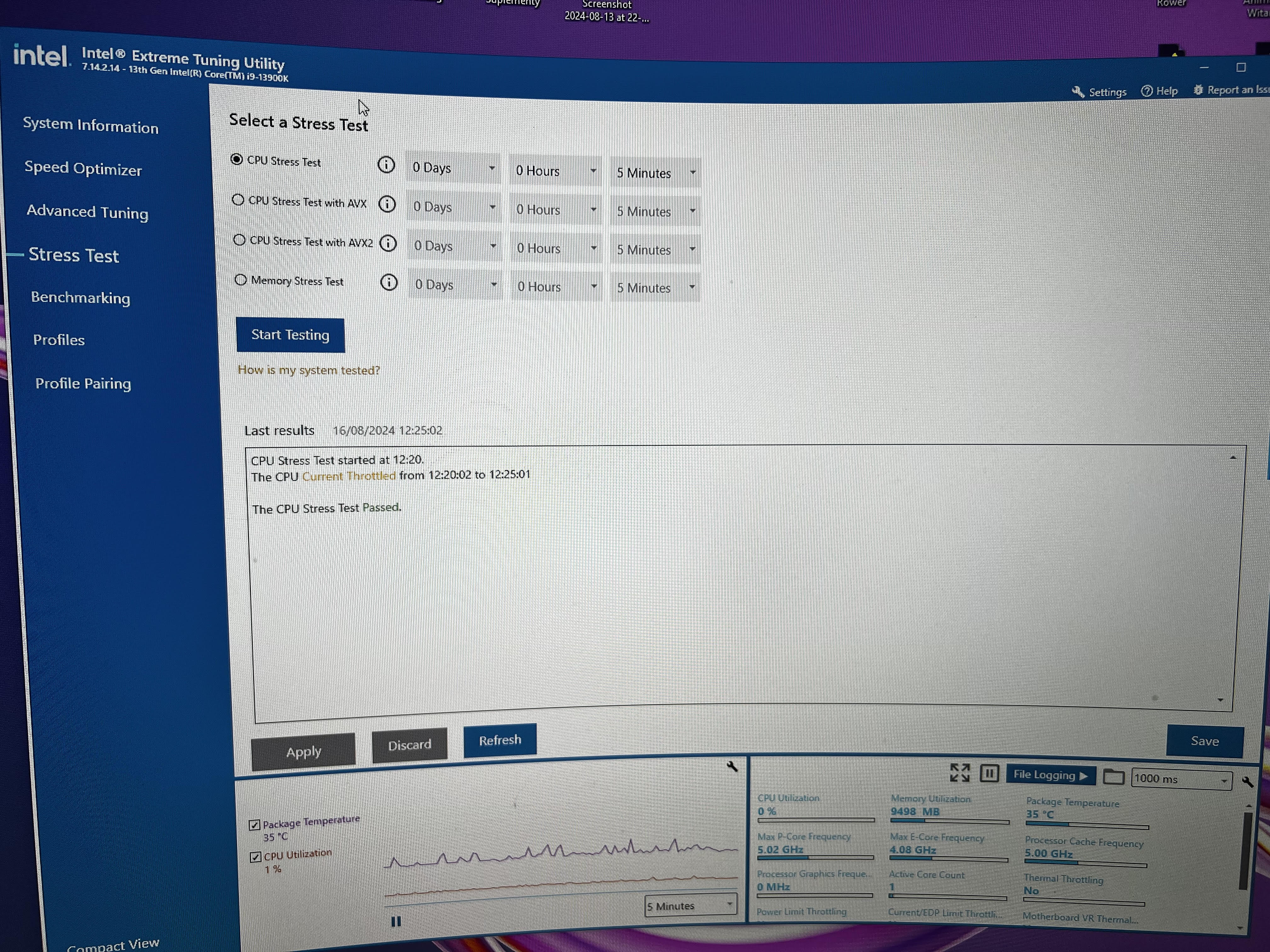

Hello everyone, I would like to ask you for help on how to get rid of Current/EDP limit Throttling
when I do CPU Stress Test in Intel Extrem, this message appears every time, please tell me the easiest way to solve this problem, my computer is new, I have an Intel i9 13900K processor, MSI Ace Max Z790 motherboard

Those messages are very normal, especially if you are using Intel's default profiles, which limit maximum current levels to prevent CPU overheating. There's no need to get rid of them, but if you want to, then you need to change the maximum current to 511A or unlimited (4095W) in XTU or your bios. They can get annoying if you are running a long stress test and the screen is filled with them.
