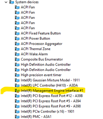

On my computer WIN 10 PC Device Manager, I see a yellow “Caution” flag next to Intel Management Engine Interface #1 device.
  • If I click on the properties section, I see the following statement:
  • “Windows cannot verify the digital signature for the drivers required for this device. A recent hardware or software change might have installed a file that is signed incorrectly or damaged, or that might be malicious software from an unknown source. (Code 52)”
  • The device has firmware version: 14.5.12.1111
  • The driver is section shows 21181100.0.1078
  • If I say check for driver update, I am told I am using the most up to date version.
  • If I run the Intel Driver & Support Assistant, I get the message: “Your Intel drivers and software are up to date.”
Question (1): Shall I uninstall this device and hope upon rebooting the yellow “Caution” flag will disappear.
Question (2): Should I disable the device and hope my computer will never ‘miss’ it?
Thanks!

Disabling the device can have consequences for features supported (like DRM), so I do not recommend that. What I do recommend is that you uninstall this device, choosing to delete all related software, and then reboot. I would next download the latest Intel Management Engine driver package for your processor/chipset from the Intel Download Center (we can point you to right package if you identify your processor/chipset) and then install it.

 I think you suggested removing this highlighted error flagged device:
And any software associated with it. Do you mean this driver associated with the device?
                      heci.inf_amd64_778912adccf3cb\x64\TeeDriverW10x64.sys
I do not know of any other software that might be associated with this device.

A version of the ME driver installation package for 10th gen processors/400 Series chipsets can be found here: https://www.intel.com/content/www/us/en/download/19488. Simply extract the contents of the ZIP file and run the MEISetup.exe.

Did as you suggested and can happily report that after rebooting and checking the Device Manager I now see no yellow triangle warning!
