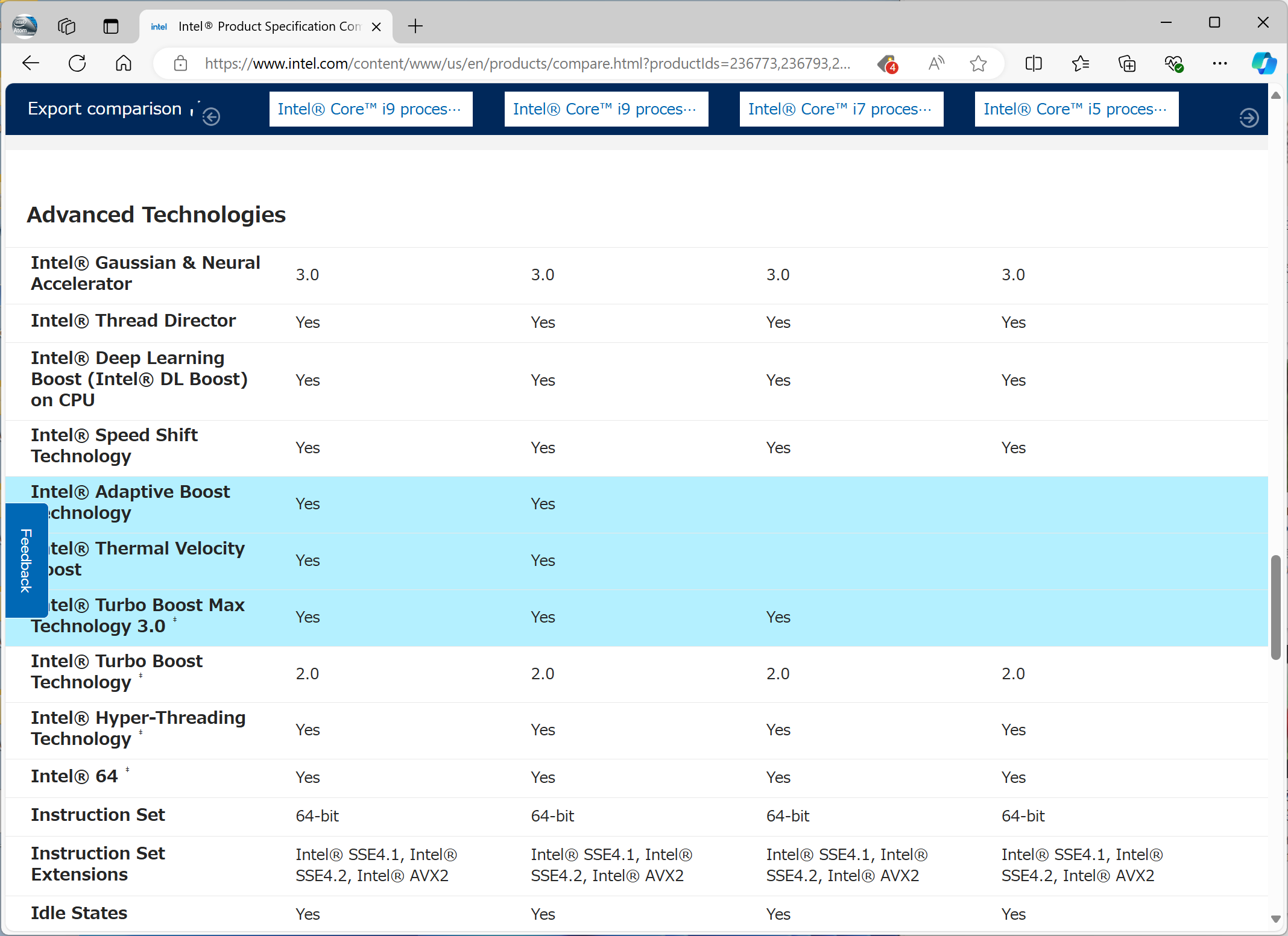

◎Does the Core i7-14700K support TVB?
Hello.
Looking at the Intel Ark specifications, TVB support is not listed.
I interpreted this as meaning that TVB is not supported.
However, YouTubers and other users have said that TVB works with the i7-14700K.
So, my questions are:
1. Does the i7-14700K support TVB?
2. If it does, please tell me which SKUs can actually use TVB.
(I thought that this was a feature that only Core i9 SKUs could use)
3. If it does not support it, is it something that can be enabled with the overclocking function?
Thank you.

According to Intel the 14700K does not support Thermal Velocity Boost (TVB). TVB can be enabled or disabled, and controlled with some motherboards through a BIOS setting that should only be available if a processor with TVB support such as a 14900K is fitted. I have seen YouTube videos where a motherboard fitted with a 14700K still allowed TVB to be enabled and configured. In one case the motherboard was the ASUS ROG Maximus Z790 Dark Hero.
I do not know if subsequent BIOS revisions have changed the ability to do this so it cannot be assumed that the facility is still available. Clearly it is outside of Intel's specifications and for this reason I would not in any case recommend it.

Thank you.
I was unable to confirm whether the Core i7-14700K supports TVB outside of Intel Ark, and I couldn't find any confirmation in official announcements or documentation, and there were people who claimed that TVB could be used, so I wasn't entirely confident about saying that it was "not supported."
By the way, if there is a way to check SKUs that support TVB other than Intel Ark, please let me know.

hello there ikjd0817
According to the specifications listed on Intel Ark, TVB support is not officially listed for the i7-14700K. Typically, TVB is a feature associated with higher-end SKUs such as Core i9 processors. While the i7-14700K does not officially support TVB according to Intel's documentation, it's possible that some users and influencers have reported otherwise based on their own testing and observations. However, this may vary depending on specific motherboard implementations and BIOS settings. TVB is a feature that is typically not enabled through overclocking. It's designed to operate within specified thermal and power limits set by Intel. Overclocking can potentially affect power delivery and thermal management, but it does not directly enable TVB on processors that do not officially support it.

Thank you.
So it's not something that can be enabled with the overclocking function, but rather it could be that the motherboard has a feature that allows you to turn it on separately, or it could be a bug or a misunderstanding, so essentially TVB can't be used with the i7-14700K.
I understand.
