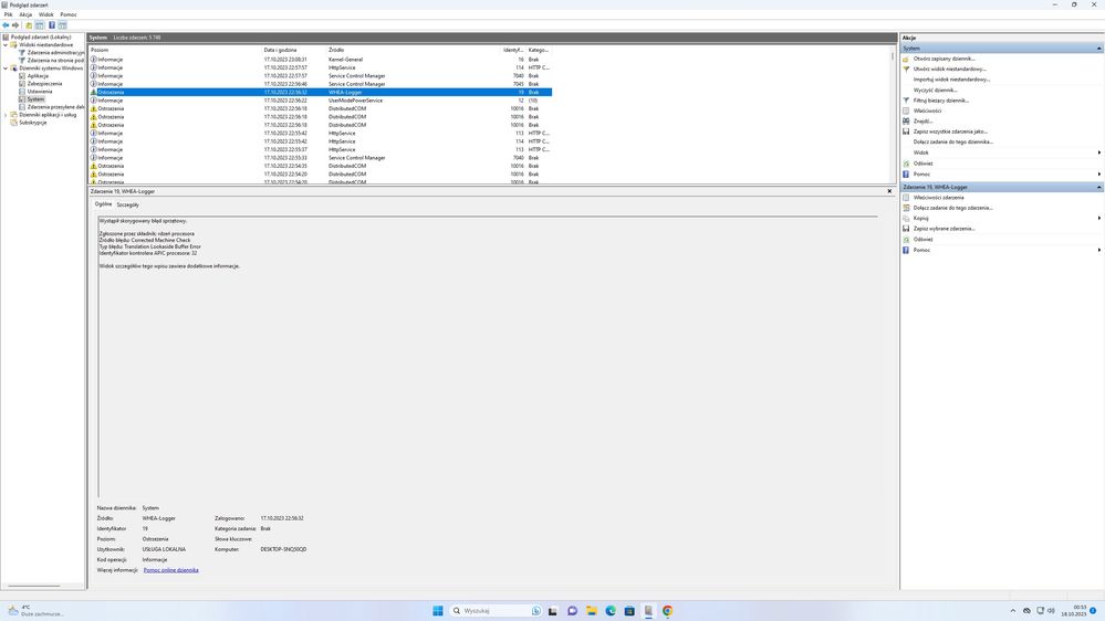

SLitw
7,600 Views
After bsod and reboot WHEA LOGGER 19 appear. I dont know why. It shouldnt ?
Corrected Machine Check
Translation Lookaside Buffer Error
screen:
This is riciciolous all should be stable from start to end. I am so mad now and have headache what to rma now. Thanks

SLitw
7,570 Views
whh
I installed 2 times graphic drivers. And after each reboot Whea 19 appeared in event log.
So reboot to windows and whea 19 appeared. The same next time.

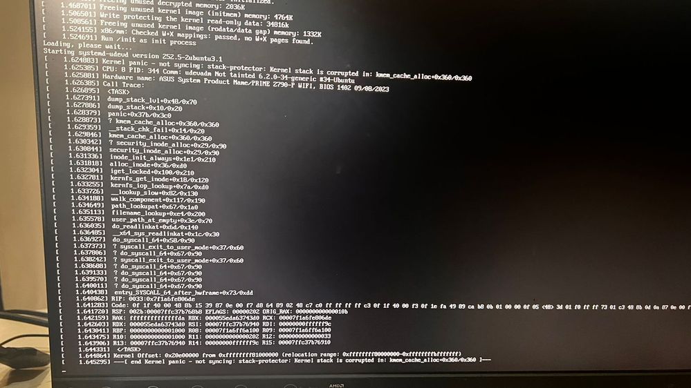

sibidharan
New Contributor II
7,549 Views
Hey @SLitw , Look at my Linux crash in the attachment. It says Kernel Stack Corrupted, Permission Violation, they are caused by something called "General Protection Fault" that's thrown by the processor. This happens only when I enable certain cores.
My errors are linux version of your errors.
Corrected Machine Check is like Permission Violation by CPU, kind of a protection fault.

SLitw
7,506 Views
Each new install of nvidia drivers, and launching Remnant 2 ( the same UE5 engine like Lords OTF ),then on first launch ,during shader compilating it throws OUT OF VIDEO MEMORY and it can BSOD. Next launches are fine.Just on first launch of the game, during compiling shaders.
The same thing happened on game Lords of The Fallen. And next launches are fine.
But like i said it will bsod again if i install new drivers and launch game for first time.
Also found ,Wheas 19 logger warnings/entries in moment when shader was compiling. Nothing more
Here are entries:
That one WHEA 19:
And that one: WHEA 19:
Corrected
Internal Parity Error
Also. I tested by Karhu Ram test no errors. Cinebench R23 passing. Games are stable. Prime95 Small FT stable no errors.
But should i rma cpu or ram?

sibidharan
New Contributor II
7,405 Views
Is RAM capable of throwing General Protection Fault?
99% of the time RAM may be the case, just with 13900k its not, please check how many people are reporting faulty 13900k!!!
I contribute to linux kernels, I know some stuffs about GPF and now its not the RAM, its the faulty CPU thats corrupting the cache/memory and thats inturn causing the processor to throw GPF and go into a lockup. In windows its manifesting as Access Violation, Overran Buffer, KMode Exception in Non Paged Area, all points to General Protection Fault.
Even booting live USB with different kernels without any peripherals attached causing the same issue, on Non Tainted kernels! You see, its the i9. Using only E-cores, the system boots with live USB.
Linux is not windows to crash stupidly. Its a faulty i9, please accept it.
sibidharan
New Contributor II
7,361 Views
I just changed to 14th gen 19-14900K and all issues are magically gone. The server is booting up butter smooth and no panics anywhere, no lockups anywhere!!
Its the bloody i9-13900K, everyone (or a subset) who bought this is silently suffering. Please change the CPU.
