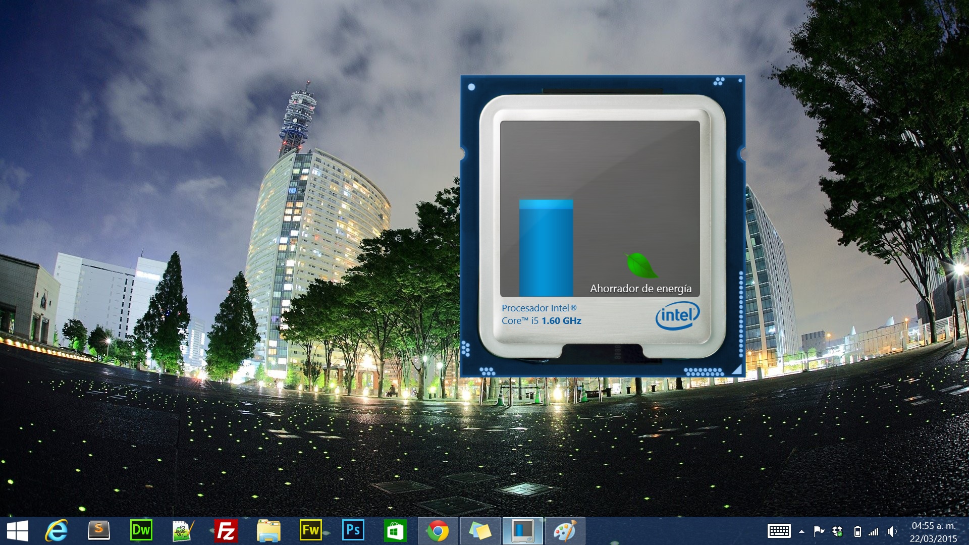

When I go to control panel windows 8.1 I get in processor features 1.6 | 1.6, and previously appeared to me: 1.6 | 2.6, I read on the internet that these processors use technology turbo boost, the detail is already installed all drivers for my motherboard (available on the website of SONY VAIO https://esupport.sony.com/LA/p/model-home.pl?mdl=SVP13215CLB&template_id=2®ion_id=2&tab=download Sony eSupport - SVP13215CLB - Soporte ) and I can not get algunam solution, I hope you can please guide me with this problem of my microprocessor.

Hello Acosta,
Please note that Intel® Turbo Boost is a feature that is automatically enabled and will be activated when the system requires more resources.
Here you have more information about this:
https://www-ssl.intel.com/content/www/us/en/architecture-and-technology/turbo-boost/turbo-boost-technology.html https://www-ssl.intel.com/content/www/us/en/architecture-and-technology/turbo-boost/turbo-boost-technology.html
As mentioned before, this is enabled by default but you can check at the BIOS level if it has been disabled at any time.
