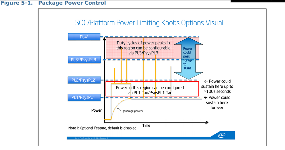

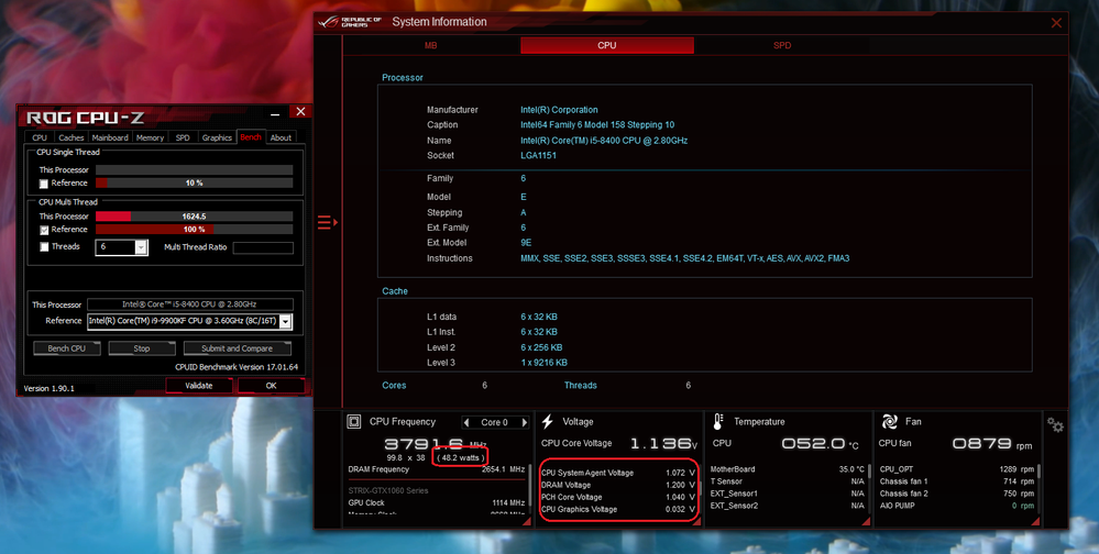

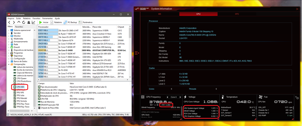

 @AdrianM_Intel I dont know if im right, but I believe my motherboard can handle 120W max (100A * 1,2V), I don't know how many time is TAU set on it to prevent toasted... But if the result follows PL1*1,25, I think the motherboard can hold an 8core/65W...or...it will toast the VRM's...
Would an octacore i9 9900(non k) consume the same power as the current hexacore i5 8400 on Turboboost (PL2 = 65w * 1.25 theoretically) at the same temperature in the same thermal solution???
I need to know before an upgrade... if i can just remove one and install the other, with no worries, changes and with the same thermal solution....
PL4?

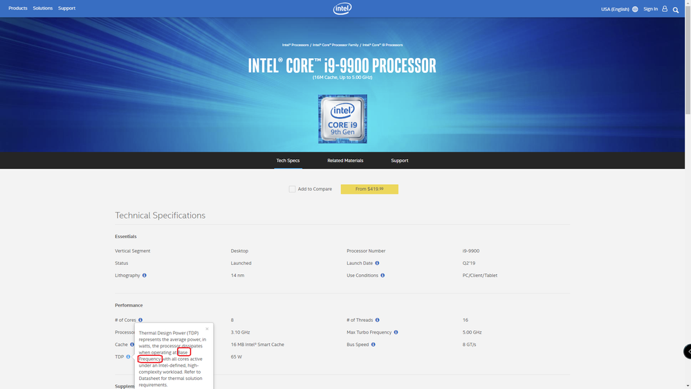

We recommend you to use the Thermal Design Power (TDP) of 65W based in our datasheet, this is the recommended TDP for this processor if you would like to set up a different temperature we do not support it since this can be considered underclocking/overclocking (We know is not K processor but if the frequencies are changed it can short the processor's life). The processor will use all its features (Max turbo boost, cores, etc) if it's working within specifications 65W.
Note: Based on the comparison I did in our website ark.intel.com both processors have the same TDP 65W Intel® Core™ i9-9900 Processor and Intel® Core™ i5-8400 Processor so even if the amount of cores is different they have the same TDP so you can remove one and install the other however a good guideline is to replace the TIM (Thermal Interface Material) if you reinstall the processor or fan-heatsink. Proper application of the TIM is crucial to the success of the thermal solution.
