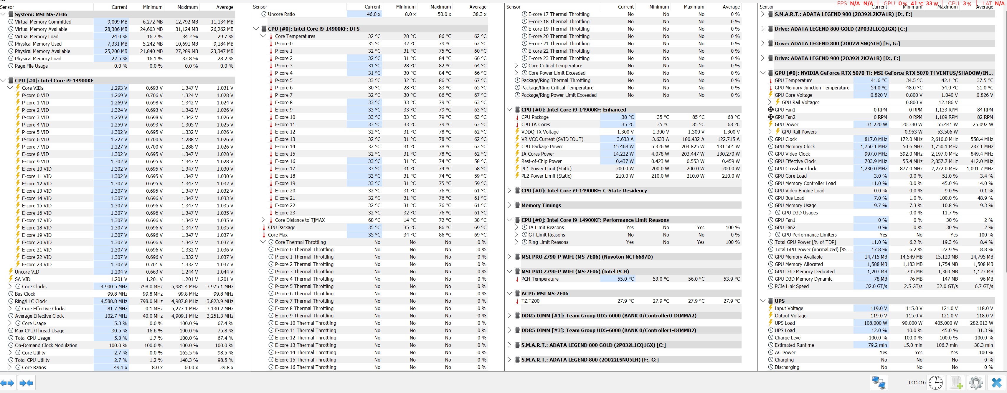

Greetings,
I have very recently become an owner of an i9 14900kf. So far I haven't run in any issues, but I came across many anxiety inducing posts regarding degradation.
For the record, I have a z790 D AX (rev 1.0) motherboard. Bios version F4b with 0x12f microcode. Which came with "intel extreme profile" and "optimized" turned on by default in it's bios. The only thing I changed so far was to to turn on XMP 1 for my RAM.
I have read so much that I don't know what to think anymore so I have to ask, am I at risk for early degradation? I am asking that because I have monitored my Vcore and it's sitting at 1.44v the lowest and usually spikes up to 1.46v while gaming. The voltage will rarely go up to 1.48v and very rarely at 1.5v. So you could say that my average Vcore is around 1.45 during heavy load.
Also, my temps are usually around 55-65 degrees celsisus and very rarely go beyond 70, only for a few seconds at a time doing the same thing.
During light loads the voltage usually works between 1.30v up to 1.45v. Averaging 1.35v. Temps are at 25-40 max during these.
My main concern is if these voltage values are normal for this specific model or if I am already degrading my processor and I have to start doing tweaks such as undervolting/downcloking before it's too late? The CPU is only a few days old after all.
So to end it, will running this processor at Vcore 1.45v on average and <70 degrees celsius for let's say (hypothethically) 10 hours a day make me run into degradation issues very early? Instead of years as I would've expected?
Thanks in advance! I apologize for the typos and lack of depth but I wrote this on a rush!

First off, your Intel i9-14900KF is a beast, but Intel out of the box already runs these chips pretty hot and pushes aggressive voltages. You’re not alone in seeing 1.45–1.5 V spikes that’s actually pretty common on 13th/14th gen under Intel’s “default” (which is really just factory overclocked) settings.
Voltages (1.45–1.5 V spikes), that’s higher than what old-school overclockers would consider safe long term (1.35–1.4 V was the “sweet spot” for years). But Intel’s Adaptive Voltage design spikes like that on light/medium load all the time. Short spikes at those voltages won’t instantly fry your CPU... but those temps are actually really healthy for a 14900KF. People on air coolers easily see 80s–90s under stress. You’re chilling compared to them. Degradation happens over time when high voltage meets high temps. The fact that your temps stay under 70 °C is already a massive plus. If you were sitting at 1.45 V AND 90 °C every day, that’s when you’d shave years off the CPU’s life. At your temps, you’re fine for years of use. What you can do is flip off “Intel Optimized/Extreme” and stick with stock Intel baseline or apply an undervolt (via Adaptive/Offset). but this is optional. Enable Intel CEP (Current Excursion Protection) in BIOS if it isn’t already. Try ASUS MultiCore Enhancement OFF / Gigabyte Lite Load / Intel’s default “Baseline profile.” These usually pull voltages back a bit. If you wanna keep it safe and still max performance, undervolting by -0.05 V to -0.1 V Adaptive offset is a nice middle ground.
Reality check, unless you’re pushing AVX stress tests 24/7, you’re not gonna see “early” degradation at your settings. We’re talking maybe after 5–7 years of heavy use the chip won’t hit the same clocks. But let’s be real, by then you’ll probably be on some 17th-gen i9 or Ryzen 10000X. Your voltages look scary on paper, but they’re normal for 14900KF behavior. With your temps staying sub-70 °C, you are not at risk of rapid degradation. If it bugs you mentally, undervolt a bit for peace of mind, otherwise, game on and stop stress-scrolling forums
you can check this, Intel Core 13th and 14th Gen Desktop Instability Root Cause Update
Guidance regarding Intel Core 13th and 14th Gen K/KF/KS instability reports

Hearing that is indeed comforting. Since I made this post I have tried to make a few tweaks. I went into bios and set a voltage offset of -0.070. Without changing anything else. Did a few tests and played for a while without any issues. My Vcore went from 1.44v to 1.38v on average. Temps even if they weren't of any concern have also went down by atleast 5 degrees on average and up to 10-15 in some other scenarios.
On paper/stress tests I have lost a bit of performance like maybe 1-3%. But in games, where it actually matters for me or rendering, I didn't notice any change. My fps is the same, clocks at around 5000-5500 on average, load times the same, etc. On idle while sitting in menus or very low activity it usually sits at 1.4 and max clock speed but since it's during low load it won't cause any harm. I didn't check the wattage during low and heavy loads too but the pl1 and pl2 is at 253w as it should be. So I guess it should be fine.
1 of my games froze and had to end the task yesterday but I think it was some other issue involved tbh. Not because of undervolting instability. Still, I will keep an eye on that and make tweaks accordingly.
It's good to know that even if I left it like that it would've lasted for years and it's true that, by the time issues would arise, I will probably look for an upgrade. But I hope I won't have to for at least 5 years haha.

Interestingly enough, after testing even more games, I have noticed that usually the less demanding ones tend to have 1.4v on average jumping up to 1.42v at times and about 130w. Instead of 1.38v. Which is a bit unexpected, but in the grand scheme of things I should still be safe. Since like the comment above said, that these values are the norm and safe for such high-end cpus.
In both cases, whether the voltage is higher or lower temps very rarely exceed 65 degrees and if they do it's only for a few seconds. The average is usually around 55 degrees.
Besides, even if the voltage is higher in some games, which makes sense. Voltage never goes over 1.42 (1.415v to be more precise), even for spikes. Compared to before when it could go up to 1.5v and would average 1.45v+.

Now, let's talk about the temperatures, voltage and load. As you know, my temps tend to be at around 55 on average across all games. But in games such as overwatch 2 which aren't that demanding (at 4k 180 fps). Here voltages tend to be a bit higher, averaging 1.4v spiking up to 1.42. In demanding games such as kingdom come deliverance 2, temps are slightly higher averaging 60 degrees but the voltage is at 1.38v instead(still at 4k 140-180 fps). In both cases though, my temps rarely exceed 65 degrees and if they do it's only for a few seconds. I usually cap my fps at 180 fps since that's how much I my monitor can handle.
Stress tests are another story, in CB R32 for example, my voltages are surpisingly low between 1.20v-1.35v rarely going over that amount for a few seconds. Temps on the other hand are jumping between 70-75 degrees and sometimes go over that amount for few seconds. They never went over 80 at any time though. I have done some more stress tests using intel XTU or intel processor diagnostic tool and the results are pretty much the same. People will tell you that for a proper stress test you should use OCCT, but tbh you are never going to realistically run your system at such power for daily/gaming use.
Your temps combined with the average voltage you are experiencing are definitely concerning, at least from my point of view. As to why your temps are so high, it could be because of a number of reasons.
First of all, you will see that these cpus will usually run quite hot under load 75-85 degrees and at a high voltage as well 1.45v or more. By design, like the comment above said, the voltage is quite high compared to what used to be the norm. But combined with high temps like yours, it will definitely not be healthy over time.  Even if you values tend to be common for 14 gen cpus.
Second of all, cooling. Your case might be a bit crowded or perhaps the airflow and position of the fans is set up incorrectly. You can see proper airflow and position of the fans to achieve it in the above picture. Also, it is painfully common for the CPU to have been poorly mounted. With bad quality thermal paste, too much or too little thermal paste or even terrible such as leaving the plastic label on it. All of these resulting in horrifying temps and degrdation. To blame are the ones that prebuilt your system, being on a hurry or just uncaring. Which is a thing that happens often to GPUs as well.
Another reason could be that you are pushing your system in a different way/ harder way. I game at 4k 180 fps, if I leave the fps uncapped, surely the temps will go up by a tiny bit 1-3, maybe more degrees. But in a supposedly poorly cooled environment those few degrees could be multiplied dramatically. I'd expect if you game at 8k and or with more fps let loose than I do, your temps might be higher in general. It's impossible to hit more than about 180 fps at 4k or 8k in very modern/demanding games even with the best specs out there though.
Your other components such as the GPU might be blowing hot air too which could contribute to the overall high temps. Maybe the GPU pulls too much voltage and results in high temps evacuated around it. Undervolting the gpu and or cpu will help with temps if done correctly but it shouldn't be needed unless these components already operate at their designed/safe voltages.
We also seem to have slightly different specs. I have an RTX 5090 Gamerock Palit, different components means better or worse cooling/performance. This specific gpu model is also known to handle temps better than others out there. Although, I can't confirm that myself. I also took a look at your PC case it looks really cool tbh, combined with your specs, you have a monster of a PC :D. But, I can tell that the airflow in here is poorer. Slightly less space, way less spots where the air can circulate in and out, different fan position, etc.
Some or all of these things combined might make you have very high temps. There might also be contributing factors we are missing. More experiments and troubleshooting required.

Thank you so much for all this information, your help has been amazing! As you originally commented, some of us read so much we don't even know what to think anymore.  I love your case and setup, I didn't even think about fans in the bottom, so I had to check mine, and of course the PSU fan did have some dust on it that needed cleaning out.  There is a "false" floor above my PSU that separates it from the rest, I really like that yours is completely open with three additional fans.  I just have to be completely realistic, its my first jump into the gaming computer field and when buying an unknown pre-built system sometimes you get what you pay for.  I am going to read every one of your links and go through everything with a fine tooth comb, and hopefully by this time next year I will be in a position to custom build and put together my own system.  One thing I have to say is I have had ZERO issues with this machine running MSFS 2024.  I have had no crashes, no software crashes or hardware crashes, it has been completely stable and a joy to have, except when I installed HWinfo and saw all these hot temperatures.  They offered me a new CPU but I haven't accepted that offer as I don't know that what I will get may be worse than what I have currently.
I have tweaked the fan curve to run at max power, finally learned some more DLSS settings and GPU tweaks so now its much lower, and yes lowered the FPS.  I think I am going in the right direction.
One thing I can say is that I got the voltages down and temp (barely) by getting to lite mode 4, but when I tried the offset undervolt it crashed multiple times.  So I jumped to mode 11 and worked down to mode 8.  Should I scrap the lite mode settings and go with .070 like you did?  Or should I try .040 and lower the lite mode a notch or two?
I am posting my settings and notes below, any feedback is greatly appreciated.

CBR23          Max Temp         V         Notes
36,109            100C                              Factory BIOS
35,955             101C                             Updated BIOS - power limit 253/253
35,974              92C            1.457         Lite Mode 11
36,792             84C             1.375         Lite Mode 6
36,857              91C             1.36          Lite Mode 5
36,808              90C             1.382        Lite Mode 4
36,994              87C             1.43           Lite Mode 11, CPU Core Offset -.050
37,389              86C             1.347        Lite Mode 8, CPU Core Offset -0.50
Crash – Lite Mode 4, Lite Mode 6 negative offset .050 – jumped back to 11
Enhanced Turbo – Disabled
Intel Turbo Max 3.0 - Disabled
Short Duration – 210w, Long Duration – 200w
CPU (a) – 307
IA CEP – disabled
IA CEP 14th – disabled
CPU undervolt protection – disabled
CPU Core voltage mode – offset
CPU offset mode – [-] by CPU
CPU Core voltage offset - .050
Rolandbox
3,984 Views
Thanks for your replies and for sharing the results! Also, don't worry. I have ran into the same issues as you when I tried to write down a message here.
After looking over the changes you've made, I'd say you did a pretty good job. Your temps have dropped considerably and you are now sitting at a safe value. You are averaging around 64C degrees and not exceeding 86C which is great. I'd recommend you stick with this current setup, which is Lite Mode 8, CPU core offset -0.50.
Making these tweaks straight from BIOS was also the right call as programs are less reliable in terms of stability and compatibility with other apps and games currently running. Although it's good to use an app to undervolt for the first time so it's easier to make tweaks instead of restarting each time. And in case something goes wrong (unable to boot) the changes stay in the program rather than the BIOS itself. But you don't need to do that anymore.
As for the voltage, to know for sure if you are in the safe range, you need to check in hwinfo for "CPU core voltage" or "CPU Vcore. It's the specific voltage supplied to your CPU by the motherboard. That is the one that should be monitored, every other kind of CPU voltage measurement there isn't what we need. You can also activate the overlay and check your Vcore directly in-game if you wish. If the Vcore averages <1.4v with rare spikes for few seconds up to even 1.5v you should be very good. Although if you are averaging 1.45v- 1.50v and spikes exceed the maximum 1.52 voltage allowed combined with high temps, it will definitely make your cpu degrade faster. Not to a very dangerous degree as these voltages are the norm for 14 gen CPUs especially after the BIOS updates, before the updates they could easily exceed 1.5v which wasn't safe at all. But eveything over 1.45v on average combined with high temps for a long time will definitely lead to premature degradation. Your temps look fine, meaning that the Vcore should also be running at a safe value, but we need to check to be sure.
As for the other BIOS changes you've made, they will also make a difference in performance and temps.
Disabling enchanced turbo and intel turbo max 3.0 will def help with temps but will also be the most costly in terms of performance loss. Although in games it shouldn't really make a noticeable difference. Even stress tests might show a negligible change. Especially if the undervolting was done correctly.
In our case disabling IA CEP and still being able to run the tests and game smoothly without a loss in performance (37000+ score) means it was done accordingly.
The short and long power duration tweaks you've made should also bring nice performance since they operate between the parameters and should lower temps especially if your cpu was always pushing above these before.
Everything else had to be done so you would be able to undervolt.
thank you
36,109                             100C                                Factory Bios
35,955                             101C                                Updated Bios – power limit 253/253
36,994                             87C                    1.43     Lite Mode 11, CPU core offset   -.050
37,389                             86C                    1.347   Lite Mode 8, CPU core offset   -.050
CPU (a) – 307
IA CEP – disabled

Thank you so much for the links and information, it is greatly appreciated. I thought I was going to stay at mode 8 and negative .050 but I thought I would be greedy and run .045 and mode 7 - results - 37,328 CBR23, 84C max temp, CoreVid 1.363, VCore 1.320
Rolandbox
3,697 Views
Thanks for your reply and I'm glad I was able to help!
Haha I see! Now that we know the Vcore as well under stress tests it is clear now. Your temps and Vcore look safe under heavy load. With this setting you have slightly higher temps which shouldn't do any harm and you also won a tiny bit of performance. You could either stick with this for the slightly better performance or the other lite mode 8 -0.50 for safer temps.
Although the difference is neglicible in both cases, you have done a great job and have reached safe temps and voltage while also maintaining the high performance of this CPU.
In the end, any of the 2 options are great for daily and longevity. Congrats :D!!
swampbuggyguy
3,591 Views
I say I am going to stop here, but who knows, but I am pleased with the results so far..........
-.035 and Lite Mode 5: Max Temp 82C, CoreVID 1.339, VCore 1.336, CBR23 37,306, short duration 210w, long 200w
I did run a combination that got me a high of 37,567 but with 88C temps, I am thrilled to be in the 82C range
Rolandbox
3,228 Views
Certainly a huge difference compared to what you had when you first came here. You achieved safe voltage and temps with a non-invasive procedure.
May you enjoy gaming anxiety free from now on :D!!
