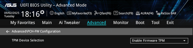

Not a processor issue. The error being reported here is that TPM 2.0 is not present or not activated in the BIOS. This is a security setting that Microsoft is insisting must be present and activated before Windows 11 can be installed. So you need to go into your BIOS and set the TPM Device Selection to Enable Firmware TPM. TPM 2.0 can be enabled through firmware or a separate adapter. It was common for the BIOS to default to the separate adaptor setting, rather than the firmware which then causes the error you are seeing. The graphic below is from my ASUS BIOS, your motherboard BIOS may be similar.

As already stated your CPU is compatible with Windows 11 and the issue here seems to be only that the correct BIOS settings are required.
There are three BIOS settings that are required for Windows 11 to install and run. You have an ASUS motherboard so I will use screenshots rather than describing in detail how to find and set the BIOS settings.
The first is that TPM Device Selection is set to Enable Firmware TPM. There is a Discrete TPM alternative but this only works if a TPM 2.0 module is plugged into your motherboard. Most motherboards do not have this unit plugged in so the Firmware setting is essential.
The second is that Secure Boot is set to Windows UEFI mode, see screenshots below
The third is the CSM setting, see the first screenshot above. Launch CSM needs to be Disabled but the Secure Boot setting seems to set it to Disabled and grey this setting out automatically but is might be worth checking, see screenshot below
