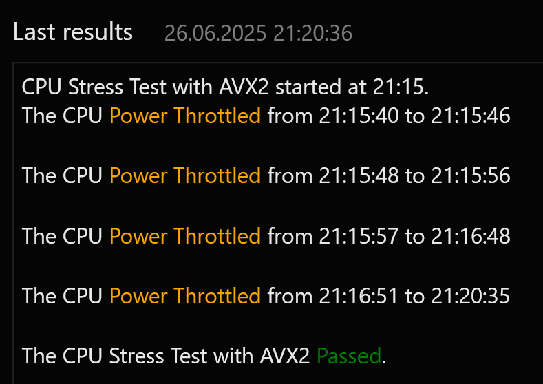

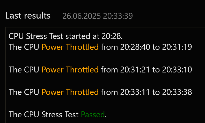

marko22
4,935 Views
Hello Jeanette,
I finally found some time to run the tests. So here’s what I’ve got: The IPDT processor test completed successfully with memory set to 8000MT/s. XMP I profile in BIOS, all other settings left at default. Up to 8400MT/s, the XTU test passes all four options without issues.
At 8600MT/s, the test ran for about 7 minutes on the AVX2 option, and then the computer rebooted. A memory management issue. Screenshot from the WhoCrashed app is below. Previously I had a System_Service_Exception error.
Well… if I have to stay at 8000MT/s, I’ll just have to live with it.
Still, it bothers me. Overall, I feel like the system is strangely sluggish. Recently I built a PC using my old processor and a Gigabyte motherboard, along with my RTX 3090—and subjectively, it seems to run better than my current platform. I have no idea what to do about this.
Regarding testing the CPU and memory on another motherboard... unfortunately, I don't have that option.
Best regards.
Mariusz M.
