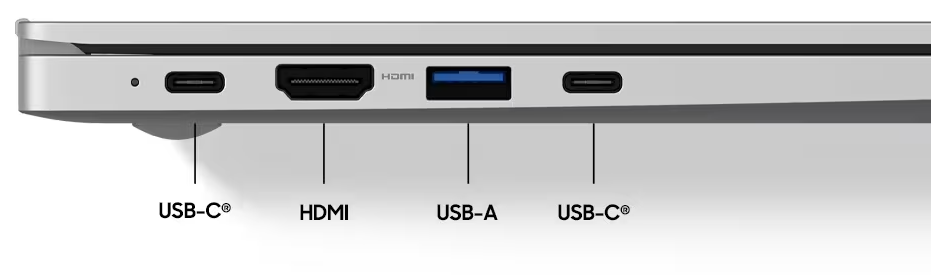

Mrsha
7,367 Views
It's a laptop. Samsung book, np550xda.
Mrsha
7,354 Views
To be more precise just in case, I found it on the box: NP550XDA-KH2BR

Honored Contributor I
7,335 Views
Samsung Book 15 NP550XDA-KF2BR ?
https://downloadcenter.samsung.com/content/UM/202208/20220829150551169/Win11_Manual_ENG.pdfhttps://downloadcenter.samsung.com/content/UM/202208/20220829150551169/Win11_Manual_ENG.pdf
Is this correct?
According to my sources the HDMI output is only version 1.4
So this may explain why you can't get 4K @ 60 Hz RGB.
The manual, however, states:
i5-1135G7 can output a DisplayPort signal according to version 1.4a HBR3.
IF Samsung did wire this correctly to the USB-C port, then you can use an appropriate adapter to bring 4K @ 120 Hz RGB 4:4:4 HDR10 via HDMI 2.1 to your impressive TV.

Mrsha
7,332 Views
No, this is not mine. Mine has in order: Charging port, network port, HDMI, USB, USB-C, 3.5mm headphone jack.
Here: https://downloadcenter.samsung.com/content/UM/202101/20210122141231319/Win10_Manual_ENG.pdf
Mrsha
7,327 Views
Also, I can run at 4k 60hz (without rgb/444), which is more than HDMI 1.4 supports, so I'm 100% that it is HDMI 2.0/2.0b.
