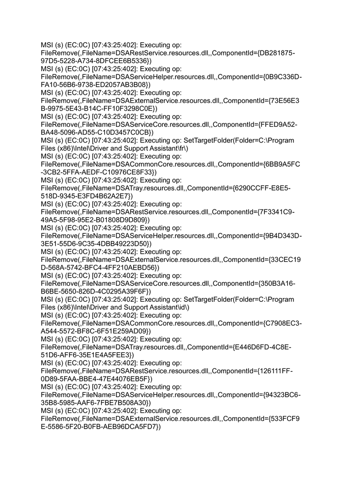

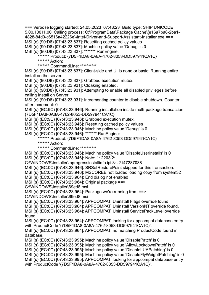

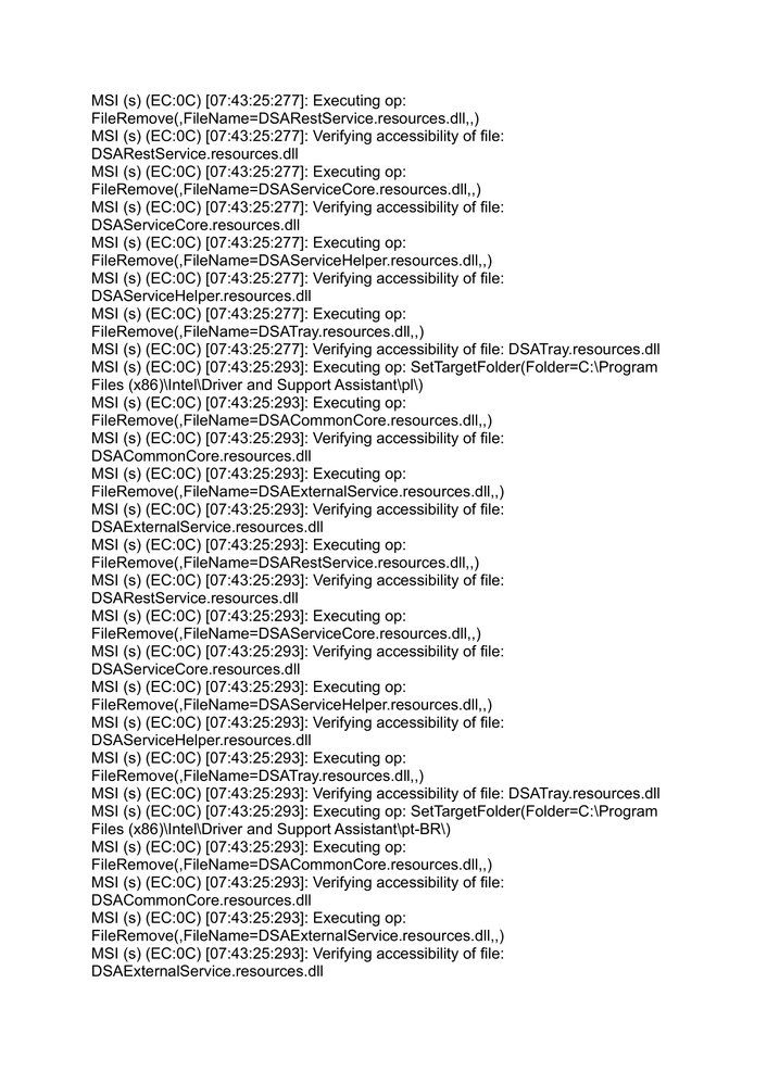

Thalmi
5,371 Views
Installer Log-FilesInstaller Log-FilesInstaller Log-FilesInstaller Log-FilesInstaller Log-FilesInstaller Log-FilesInstaller Log-FilesInstaller Log-FilesInstaller Log-FilesInstaller Log-FilesInstaller Log-FilesInstaller Log-FilesInstaller Log-FilesInstaller Log-FilesInstaller Log-FilesInstaller Log-FilesInstaller Log-FilesInstaller Log-FilesInstaller Log-FilesInstaller Log-FilesInstaller Log-FilesInstaller Log-FilesInstaller Log-FilesInstaller Log-FilesInstaller Log-FilesInstaller Log-FilesInstaller Log-FilesInstaller Log-FilesInstaller Log-FilesInstaller Log-FilesInstaller Log-FilesInstaller Log-FilesInstaller Log-FilesInstaller Log-FilesInstaller Log-FilesInstaller Log-FilesInstaller Log-FilesInstaller Log-FilesInstaller Log-FilesInstaller Log-FilesInstaller Log-FilesInstaller Log-FilesInstaller Log-FilesInstaller Log-FilesInstaller Log-FilesInstaller Log-FilesInstaller Log-FilesInstaller Log-FilesInstaller Log-FilesInstaller Log-FilesInstaller Log-FilesInstaller Log-FilesInstaller Log-FilesInstaller Log-FilesInstaller Log-FilesInstaller Log-FilesInstaller Log-FilesInstaller Log-FilesInstaller Log-FilesInstaller Log-FilesInstaller Log-FilesInstaller Log-FilesInstaller Log-FilesInstaller Log-FilesInstaller Log-FilesInstaller Log-FilesInstaller Log-FilesInstaller Log-FilesInstaller Log-FilesInstaller Log-FilesInstaller Log-FilesInstaller Log-FilesInstaller Log-FilesInstaller Log-FilesInstaller Log-FilesInstaller Log-FilesInstaller Log-FilesInstaller Log-FilesInstaller Log-FilesInstaller Log-FilesInstaller Log-FilesInstaller Log-FilesInstaller Log-FilesInstaller Log-Files
Thalmi
5,362 Views
Installer Log-FilesInstaller Log-FilesInstaller Log-FilesInstaller Log-FilesInstaller Log-FilesInstaller Log-FilesInstaller Log-FilesInstaller Log-FilesInstaller Log-FilesInstaller Log-FilesInstaller Log-FilesInstaller Log-FilesInstaller Log-FilesInstaller Log-FilesInstaller Log-FilesInstaller Log-FilesInstaller Log-FilesInstaller Log-FilesInstaller Log-FilesInstaller Log-FilesInstaller Log-FilesInstaller Log-FilesInstaller Log-FilesInstaller Log-FilesInstaller Log-FilesInstaller Log-FilesInstaller Log-FilesInstaller Log-FilesInstaller Log-FilesInstaller Log-FilesInstaller Log-FilesInstaller Log-FilesInstaller Log-FilesInstaller Log-FilesInstaller Log-FilesInstaller Log-FilesInstaller Log-FilesInstaller Log-FilesInstaller Log-FilesInstaller Log-FilesInstaller Log-FilesInstaller Log-FilesInstaller Log-FilesInstaller Log-FilesInstaller Log-FilesInstaller Log-FilesInstaller Log-FilesInstaller Log-FilesInstaller Log-FilesInstaller Log-FilesInstaller Log-FilesInstaller Log-FilesInstaller Log-FilesInstaller Log-FilesInstaller Log-FilesInstaller Log-FilesInstaller Log-FilesInstaller Log-FilesInstaller Log-FilesInstaller Log-FilesInstaller Log-FilesInstaller Log-FilesInstaller Log-FilesInstaller Log-FilesInstaller Log-FilesInstaller Log-FilesInstaller Log-FilesInstaller Log-FilesInstaller Log-FilesInstaller Log-FilesInstaller Log-FilesInstaller Log-FilesInstaller Log-FilesInstaller Log-FilesInstaller Log-FilesInstaller Log-FilesInstaller Log-FilesInstaller Log-FilesInstaller Log-FilesInstaller Log-FilesInstaller Log-FilesInstaller Log-FilesInstaller Log-FilesInstaller Log-FilesInstaller Log-FilesInstaller Log-FilesInstaller Log-FilesInstaller Log-FilesInstaller Log-FilesInstaller Log-FilesInstaller Log-FilesInstaller Log-FilesInstaller Log-FilesInstaller Log-FilesInstaller Log-FilesInstaller Log-FilesInstaller Log-FilesInstaller Log-FilesInstaller Log-FilesInstaller Log-FilesInstaller Log-FilesInstaller Log-FilesInstaller Log-FilesInstaller Log-Files
Thalmi
5,360 Views
I have sent the most of my installer Log-Files of the incomplete installation of Intel Driver Support Assistant on may HP PRoBook 450G....
I Hope, someone can see what is the issue for my problem.
