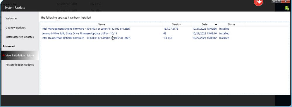

I ended up updating 3x firmware on the system.
Since installing these firmware updates, the system is running a lot better.  However, I still think there's something wrong with that Intel Dynamic Tuning Technology driver.
Not closing the book on this yet.
