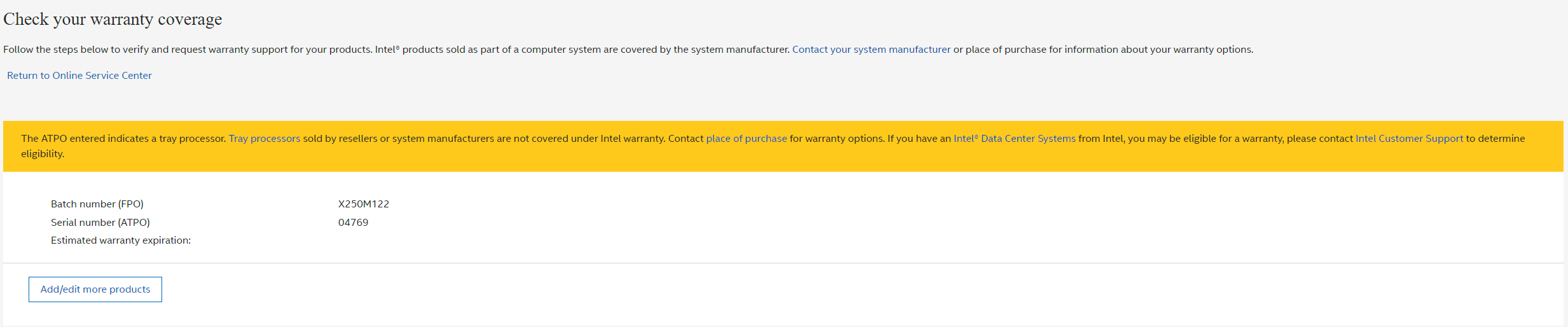

Stop editing the post and submit a warranty request.

Don't know how, seller is in another country and it is OEM. No any way to fix by hands?

What is there to fix?   The answer is that there is no warranty.  You are out of luck.
