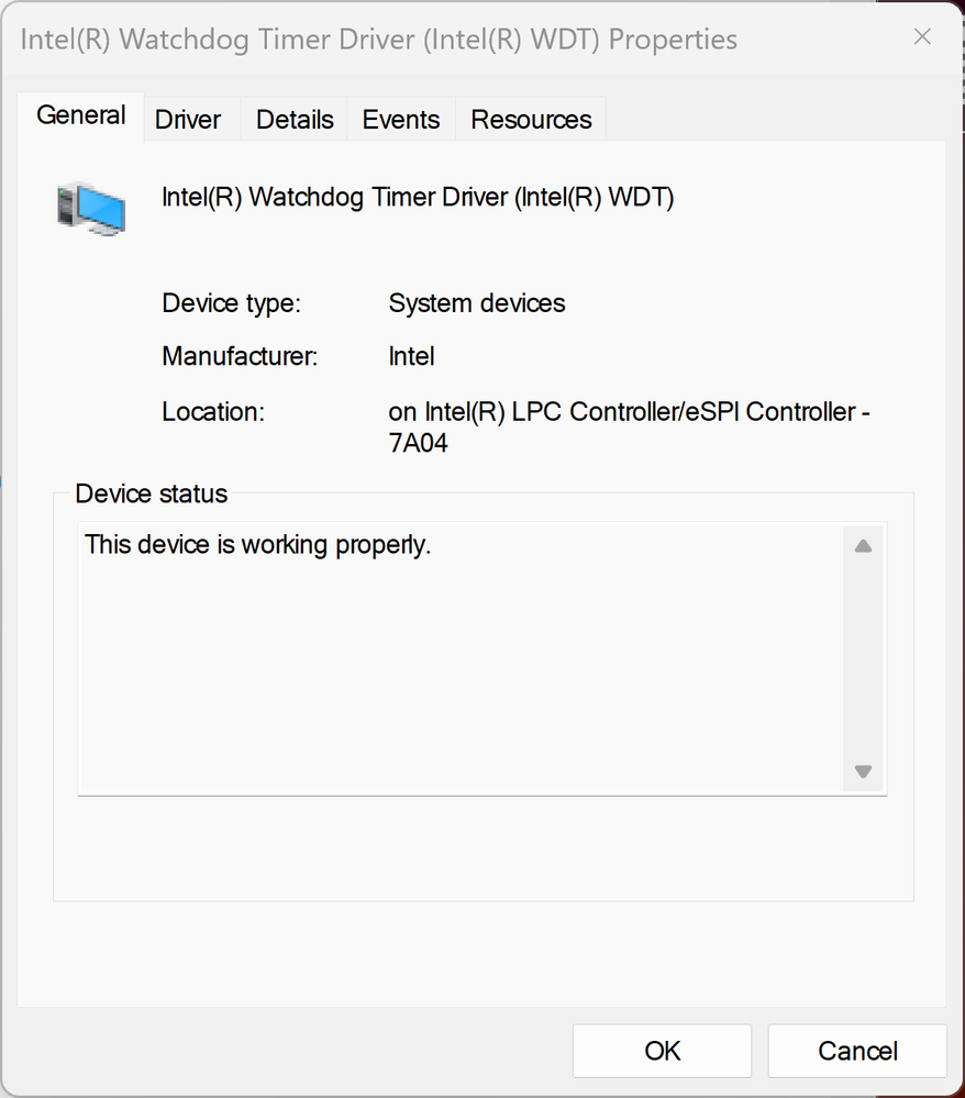

generalguy
초보자
3,996 조회수
Hi albert
According to device manager the included ICCWDT in XTU appears to be matching to the right device and working correctly:
0 포인트
Alberto_R_Intel
3,967 조회수
Hi generalguy, Thank you very much for your response and for providing the picture.
Perfect, it is great to see that the included ICCWDT in XTU appears to be matching to the right device and working correctly, since in some situations, that is not the case.
So, just to confirm, after sharing those details, is Intel® XTU still crashing?
Albert R.
0 포인트
