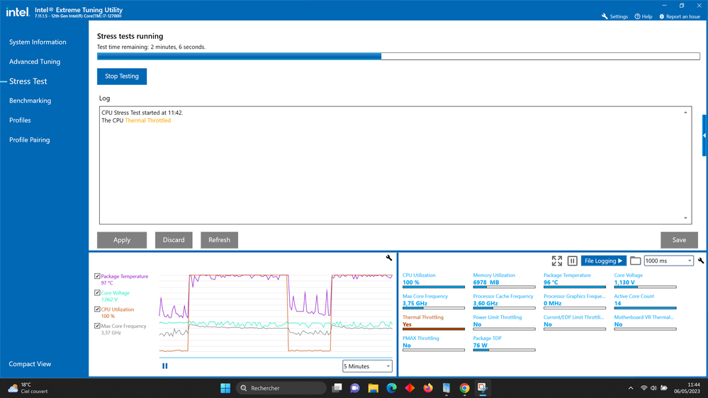

Jérémy
25,086 Views
Hi @Carlos_L_Intel ,
Thank you for your answer,
  • Run the CPU stress test with the Intel® Extreme Tuning Utility and provide a screenshot of the process halfway through and send it to me.
I ran the test. Here is the screenshot.
The frequency stayed around 3.5 GHz for the whole test, but all 14 cores were active. It might be interested to run a stress test with only one core to see the 4.1 Ghz, but I don't know how to do so with Intel® Extreme Tuning Utility
Jérémy Couturier
Carlos_L_Intel
25,028 Views
Hi @thinsys,
 Thank you for the information. One other thing I would like to know to continue with my research, when you run numerical simulations what is the program you use? Would you be able to check its frequency?
 It might be the CPU can be thermal throttling as well, is the computer in a well ventilated area? Have you checked for any dust accumulation?
Carlos L.
