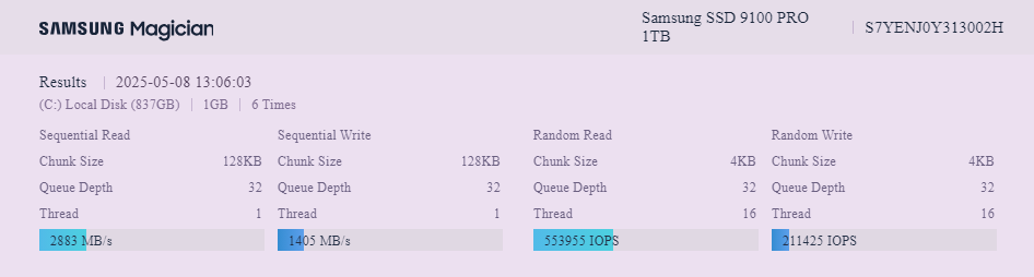

I recently installed a Samsung 9100 Pro in an MSI PRO Z890-A Wifi motherboard along with a core ultra 285K processor. I am not getting the advertised sequential read/write speeds of the 9100 Pro.  The SSD is installed in an m.2 slot that is directly connected to the CPU using 4 PCIe 5.0 lanes.
There are several other users that are experiencing the same issue as me. The common denominator is Z890 motherboard (regardless of make or model) and Arrow Lake processor, when the SSD is inserted in a PCIe 5.0 m.2 slot connected directly to the processor.
This thread is one of them: Core Ultra 285K Bandwidth limitation of PCIe 5.0 dedicated SSD port - Intel Community
I have contacted both MSI and Samsung, but neither know the cause and none of their suggestions have worked.
Since the SSD itself can reach advertised speeds except for when in the configuration described above, and since multiple users are experiencing the issue on other Z890 motherboards, I think it is time Intel escalate the issue.

To answer your questions, I have used both Samsung Magician and CrystalDiskMark v8. Both give similar results for sequential reads, but the CrystalDiskMark results give within 95% of advertised speeds for sequential writes.
I do not have another system to try the SSD in. However, there is a small chance that I may be able to find a usb adapter that can run that fast. I will let you know. It is worth mentioning that others with this issue have verified their SSD speeds can reach the advertised speeds in other configurations.

I could not find a fast enough USB to m2. converter, so I purchased a Sabrent PCIe 5.0 x 4 to m.2 converter to test this with. I had to unplug my Nvidia RTX 4070 in order to plug in the Sabrent, since that is the only PCIe 5.0 slot on my motherboard.
In that configuration, I am getting advertised speeds on the Samsung 9100 Pro. That means there is nothing wrong with the SSD.

I respectfully disagree that it is a motherboard issue for the reasons below. Please feel free to correct me if I am missing something.
1)  The motherboard manual and specifications web page for the motherboard say that the m.2 slot I am using is directly connected to the CPU with 4 PCIe 5.0 lanes. That provides plenty of bandwidth as long as the SSD is connected as PCIe 5x4 when powered up.
2)  Using the HWInfo app, it shows that it is indeed connected as PCIe 5x4 when the SSD is in that m.2 slot. I can provide a screenshot of HWInfo if you are interested.
3) Several other users with other motherboard models made by other manufacturers are experiencing a nearly identical experience to mine. It is highly unlikely that they are all motherboard issues. Please let me know if you would like links to these. One is in another thread in this forum.
One question I have for you...Have you been able to run an SSD that can achieve over 14000 MB/s sequential reads on Intel hardware in a similar configuration, and gotten the advertised speeds?

I just updated to a newly-released BIOS with Intel MR1 and 200S boost, hoping it would help, but it hasn't:
I tried it with 200S boost both enabled and disabled. The screenshot above is actually the fastest it ran. Sequential read got as low as 10000 MB/s.
Here is a screenshot of HWInfo showing the SSD is connected using PCI Express v5 and using 4 lanes:
Is there anything in particular that you would like me to take a screenshot of?
