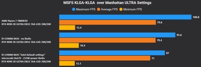

TENPATROL
17,367 Views
Won't affect performance, they said.
Microsoft Flight Simulator 2022.
Cinebench R23
FYI, after over 30 years of using Intel CPUs I’m switching to AMD because I feel deceived by Intel. For two years Intel didn’t inform us about the via oxidation issues and that’s not ok.

Yep. Intel played us all. I am gonna switch to the 9800x3d when it comes out

I understand the frustration but honestly you can't compare the CB r23 36K Intel Default Profile scores with the 40K no limits scores. What happens if you use the no limits settings with the new 0x129 bios?
