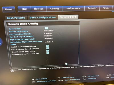

- Select the Secure Boot tab. Take another picture of the screen.
Respond here and include these pictures.

Well that eliminates the MBR issue. So it seems to be potentially a BIOS Boot setting issue.
In terms of booting into Windows 11 my desktop board only has a small number of relevant settings in the BIOS.
There is a Boot\CSM (Compatibility Support Module)->Launch CSM item that is set to Disabled.
Under Boot\Secure Boot-the OS Type is set to Windows UEFI mode. Secure Boot state is set to User which is non-changeable. And Secure Boot Mode is set to Custom.
