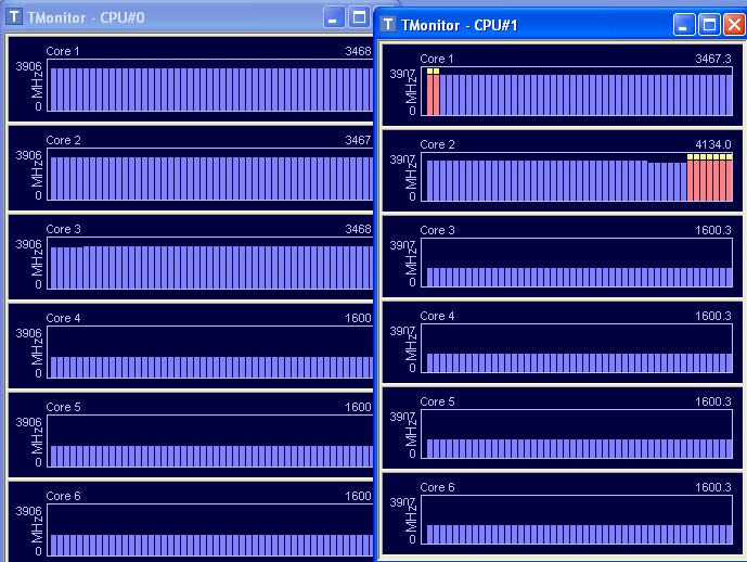

Intel Speed step will allow the system to clock down to a slower speed if the CPU power is not needed. (save $$)
Turbo boost will allow the processor to over clock safley under certin conditions.
Those are 1) you have therimal head room & 2) the total package power is as established by the imon curve is in range.
In pratice this usualy works out to one or more cores are idle, the other cores can over clock.
If you start working it hard, it will likley drop to the package rated speed.
CPUID makes a couple tools that are handy for showing the turbo boost operation. http://www.cpuid.com/softwares.html http://www.cpuid.com/softwares.html
Tmonitor will report the indivual core usage per CPU.
