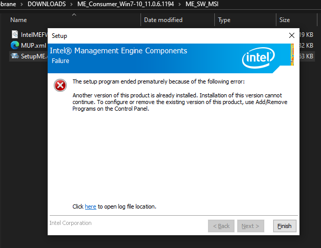

Hello, gents. please help me. I have:

PROBLEM IS, MISSING DRIVER.
INTEL HAVE NO ONE.
I`ve try:
SetupChipset.exe -> error 0x00004E24 Platrofm is not supported.

The PCI Simple Communications Controller device is actually the Intel Management Engine Interface (iMEI)You resolve and install the drivers for this interface by installing the Intel ME driver/software package provided by your Motherboard manufacturer. If you cannot find this package (or it is not for Windows 10/11), you can try the latest Intel® Management Engine Drivers for Windows® 10 and Windows® 11 package provided by Intel. I doubt that it will actually include support for a chipset this old, but worth the shot. If no luck, I have an old version in my archive that should work, but it is too large to post here. If you need it, let me know...

i`ve try Intel® Management Engine Drivers for Windows® 10 and Windows® 11

Hi ...S, thanks. I apologize for my old machine :), but it's not as old as I can imagine, it's very nice to this day :),
but after trying to install ME_Consumer_Win10_11.7.0.101 7 -> SetupME.exe ->
"..edned permaturelly,.... Platform is not supported"

I am sorry, but that's the oldest one that I saved with Windows 10 support. Unfortunately, in the release that I saved (which still supported the Z87 chipset my board has), I think Intel chose the release as a good time for removing support for older, no longer supported chipsets.
I do have a Z68 system on the shelf and will resurrect it and check what I did there to handle this issue. It may take me a day or two, however.

and when I finished installing Windows 10 Pro, the driver described below was not installed:
PCI\VEN_8086&DEV_1C3A&SUBSYS_844D1043&REV_04
I searched many places on the internet and found many fake websites with suspicious and malicious driver downloads.
I'm glad I found the Intel website, but I still didn't find anything that helped.
I don't understand why Intel discontinues support for older processors like mine. This makes our lives very difficult. What does it cost to leave the older version in the current update package?
I downloaded the Intel® Management Engine Drivers for Windows 10* and Windows 11 and could not find the driver.
I downloaded the Intel® Driver & Support Assistant and after installing it, it had the nerve to say that my system was up to date, but it wasn't true.
Simply ignored the exclamation mark ( ! ) on the PCI Simple Communications Controller.

Thank you ...S!, it works.
Despite the error (below) during installation. The missing driver disappeared from Device Manager from Unrecognized Devices.
What's more, it appeared in System Devices, got its original native name Intel Management Engine Interface (iMEI) .
In summary, the ME_Consumer_Win7-10_11.0.6.1194 version corresponds to the absence of a driver for the PCI Simple Communications Controller for the Motherboard:

Your solution works.
Admittedly, it does not solve the so-called slippery delay when moving the windows of some programs such as CPU-Z, but apparently this is not the problem.
For now, I strongly thank you for your time, and knowledge. It is super fun for me when I manage to solve something. This time I pin the order of merit on you dear ...S
P.
