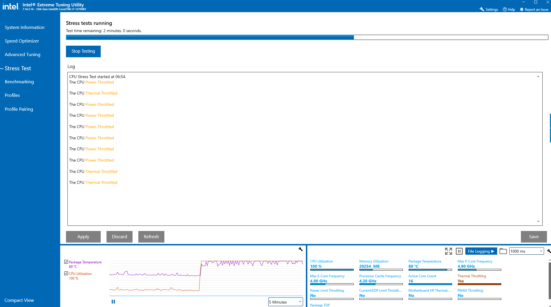

  • Collected diagnostic data using the following tools:
    • Intel® System Support Utility
    • Intel® Processor Diagnostic Tool
    • Intel® Extreme Tuning Utility (XTU)
Stress Testing:
  • Conducted two CPU stress tests:
    1. With the CPU multiplier set to 51x
    2. With the default multiplier of 53x
The performance issues remained consistent after both tests.
