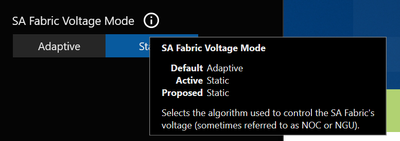

I don't know what got into me to try the default value. It breaks everything.
I had to set the values inside the BIOS.
Did I input the right value, can you (intel) fix this issue of default value, if I crash, the system tries to reload them, it's terrifying.
NumberEngineer_0-1731697427765.pngNumberEngineer_1-1731697435684.pngNumberEngineer_2-1731697442506.png

1-Yes, the default of 63 consistently crash my computer
2-use it, at all.
3-there is no default for these value on the bios
4-it wont boot
my current solution is to manually set the NGU ratio and voltage on my bios.
but whenever i do some mild overclock using intel XTU, if it fails, it force set this fabric ratio to default.. which is 63??!
As seen in this screenshot, the value is a lie. it is not running at this speed.
It's running at a ratio of 26 as shown in HWiNFO.
Please fix this, I sometime get stuck in failing boot loops.
I use the latest microcode 0x114

In the Intel Extreme Tuning Utility, the SA Fabric Ratio defaults to 63x.
Why?  Can you please answer why the default is 63x when the ratio for NGU is shown as 26x in HWInfo?
NumberEngineer - you can shutoff and unplug the computer, then do a CMOS reset. Plug in and start it up and you will get to the default BIOS.  Save your BIOS profiles, so that you can quickly reload when it occurs again.
I believe the SA Fabric Ratio is showing 63x instead of the 26x. The Help in the Intel Extreme Tuning Utility is not showing or detailing instructions for these parameters. Values above 26x need VCCSA voltages increased, which may be why it crashes the Intel Extreme Tuning Utility profile.
I have a Gigabyte Aorus Master z890 and have the same issue.

The XTU software has a bug where it will display the value of 63x for the SA Fabric Ratio WHEN the ratio is at its default of 26x in the BIOS.
Please talk to your software engineers.
1) We told you the default was 26x
2) It is defaulted, so of course the user did not make changes
3) The SA fabric mode is grayed out
4) We told you the default was 26x
5) Yes
None of your questions are relevant to what the person describes. The XTU has a bug.

Additionally, I appreciate the diligence in reporting and identifying this matter. Currently our XTU team has successfully replicated the issue as you described. Please rest assured that our team is aware with this issue now and, actively investigating potential solutions to address this discrepancy. Also, Intel is currently working with ODMs to isolate the issue ang get it fix. As w are committed to ensuring that our software provides clear and reliable information.

The defaulting of the SA fabric Ratio to 63 instead of what has been set in bios has been fixed in this last XTU release.
Thank you.
BUT
The SA Fabric Voltage does not correspond to what has been set in BIOS. It is unclear if that is because the list of voltages is limited.
Please have your engineers look into.
