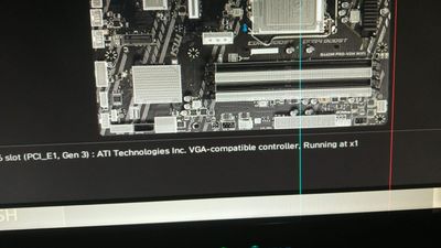

I was having performance issues since I set up the computer, so i started looking for the problem, and found from GPU-Z that the video card was working only in PCI express X1 3.0 and not X16 as usual, by the BIOS i see the same information, i already tried everything, tested another GPU, reset BIOS, updated BIOS, drivers, windows, chipset, clean install windows, take off the GPU and put again, its all fited well, so i have 2 options now, can be the CPU or the motherboard, any surgestions of how i teste them ? If can its normal this problem with a CPU or its the motherboard ?

Thank you for the information provided. Could you please check on BIOS if it shows as x1 or x16, are you connecting directly to the motherboard? Please share with us a screenshot of what's shown on BIOS.

The HWiNFO64 says that the motherboard suport x16 3.0 (8.0 GT/s) but is currently running at x1 (2.5 GT/s)

As a friendly reminder, we need to confirm if you're connecting the GPU directly to the motherboard or if you're using a riser card/other add-ins. Just to confirm, did you check the BIOS already? could you please share a screenshot of the BIOS with us? This is to confirm if the BIOS also reads it as x1.

I will give you more details, so the GPU its directly installed in the motherboard, since i notice this issue, i tried check if its not a problem of fit problem, but it seems not, i tested other GPU a GT 730 and the result was the same PCI running at x1, so i tested both GPU the RX 570 and the GT 730 in other PC, and they worked normaly at PCI x16,
following the screenshots of the BIOS and the PC.

"i tested both GPU the RX 570 and the GT 730 in other PC, and they worked normaly at PCI x16,", based on those results it seems to be that the problem is actually related to the board itself.
In order to rule out a possible hardware problem with the Intel® processor, please install and run the Intel® Processor Diagnostic Tool, it does an overall test in the unit and if it passes the test it means it is working properly and then we will know for sure if the problem is the processor or the board. Once you get the chance, please let us know the results:

I already tested, and put the results in a reply to David_G, the test was sucessefull, i just wanted a confirmation to send the mother board to the warrant, thanks.

Thank you for the update @Pedro_vitor. The diagnostic tool tells us that the processor is working fine, please check with the motherboard manufacturer for diagnostic tests or replacement. In case the issue happens again you can contact Intel live support for other options.
