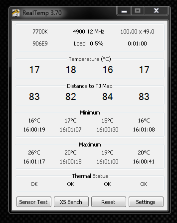

My temps are OK too, idle is 20-21 and when i open Firefox it spikes up to 30-32 ( not bad at all ) my CPU runs at 5.0GHz 1.36v, but the reason i get low temps and low spikes is because my 7700K is De-lidded and i am using a Water-chiller system, i could even make it run cooler if i want it but those temps are more than ok for me.
sometimes i used to have my 7700K running at 5c-10c idle.
This is from today - room temp 21c

As i have said before i am using a Waterchiller, and as i have said before too my CPU is Overclocked at 5.0GHz 1.36V.
You are running your CPU with 1.15V and your temps are 55-58 and i am running mine at 5.0GHz 1.36V and my temps are 33c in Gaming, that is why i love Waterchillers Btw with my WaterChiller i could low my temps up to -5c
I drop my temps -5c just for bench.

Man... those are some incredible temps... lower than ambient. Lol amazing. Makes me wanna delid mine..
I agree with RitchieDrama, these temps are normal temps for this CPU. The diference between his build and mine is that I have the same temps, maybe 1C to 3C lower but running at 4.7Ghz... But I use a non delid chip with an CM EVO 212 inside a mATX case.
I think these is a regular performance using this setup.
