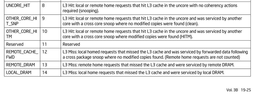

I write a simple test with two threads. One thread accesses 32-MB array on local node in a loop, the other accesses it on remote node.
According to the following test results, it seems like that data from remote NUMA node will not be cached into local L3 cache under any case. In other words, remote accessing can only be served by REMOTE_DRAM and REMOTE_CACHE_FWD.
Intel sdm about the REMOTE_DRAM and REMOTE_CACHE_FWD
gzL0c.pngI guess bus snooping is implemented for L1/L2 cache across NUMA nodes, but not for L3 cache across NUMA nodes. There are related phrases like "cross package snoop" and remote cache" in Intel sdm without detailed definition for them. So, I'm wondering where can I find the detailed specification or proof for my testing conclusion?
