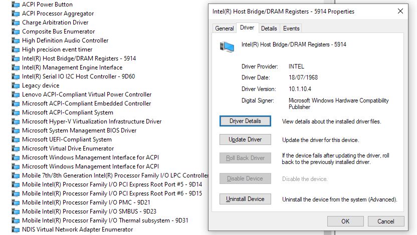

I have an i5-8250U with latest driver chipset installed. When I check "Intel(R) Host Bridge/DRAM Registers - 5914" it show version driver is 10.1.10.4 (kabylakesystem.inf). I think it should 10.1.14.7 (coffeelakesystem.inf)
See my response here (essentially same issue): https://forums.intel.com/s/question/0D50P00004OmknBSAR/why-there-is-200-series-chipset-driver-in-windows-10-pro-for-8700k-on-z370-motherboard?language=en_US
Thank you. I followed your guide by run cmd "SetupChipset.exe -overall" but no change. :(
Did you reboot before checking?
Yes, i had reboot many times but not affect. :/
Another information: I'm using Windows 10 ver 1903, device model: Lenovo 320 15ikb (81BG)
It is unclear to me why it didn't automatically revert to the INF file for Coffee Lake. Regardless, whether this matters is moot if you are not seeing any issues as a result.
