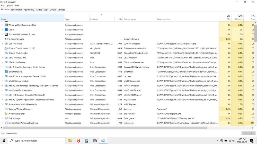

I have 10 INTEL processes running in the background.  That seems a bit overkill.  Which one can i remove or disable?

My processor is: Processor Intel(R) Core(TM) i7-10750H CPU @ 2.60GHz, 2592 Mhz, 6 Core(s), 12 Logical Processor(s)
As for performance issues, the fan on this laptop keeps running and loudly.   It started 2 weeks ago and then i noticed all those Intel processes that i don't recall seeing all of those prior to that.

Thanks for your patience. In this case, Intel cannot recommend which tasks to close/remove since some of the tasks running in the background could be needed for the computer to run smoothly.
However, based on the image shared these Intel processes are almost 0% the issue with your fan may be related to dust stock in your vents. I recommend you check with the laptop manufacturer to get instructions on how to clean your system.
