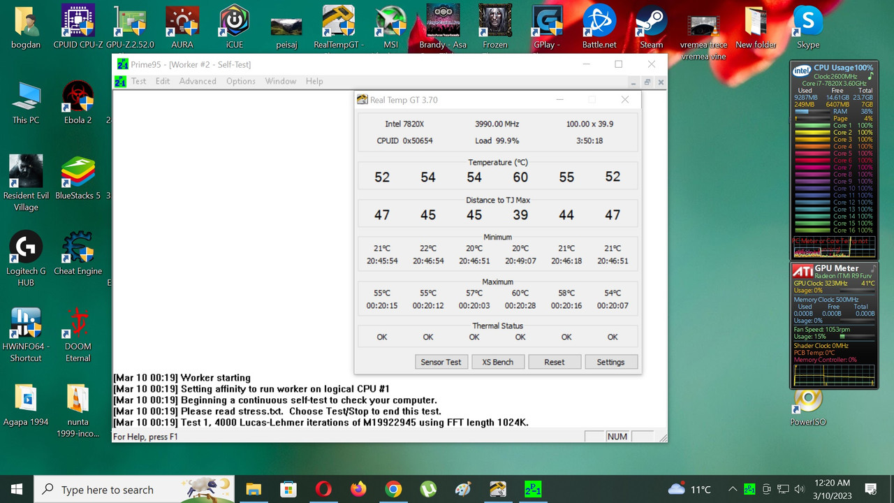

The funny things,is i checked temperature with Real Temp,and when i receive this bsod it's always when i browsing in Opera and it never goes over 40-45 degree.When i play light game like Diablo 3 for example, i never have this bsod 124 error,
I don't understand this WEIRD BEHAVIOR.Another weird thing, ichecked my temperature in idle mode and for example now i have 19-23 degree and over 1 second it goes to29-36 degree.It is posible to thermal degree is not good?I applied Arctic Mx-4

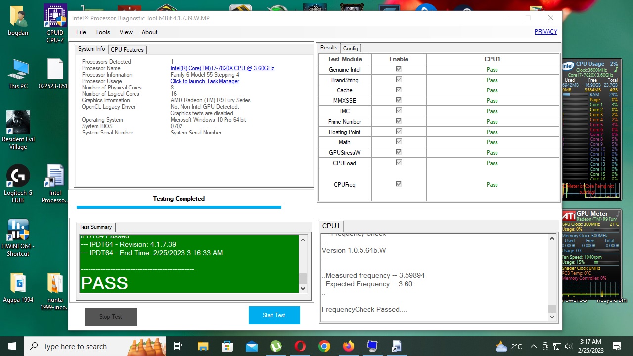

like i said before,i already tested my 7820x with intel soft diagnostic tool...and my CPU passed without problem.My BIOS version was never flashed to the latest version.My version of Bios is from 8/8/2017 .I'm scare to flash my bios because i don't have an UPS
My problem was solved from BIOS,i set CPU Core Ratio to AUTO,and bsod problem dissapear.With Core usage settings ,cpu become unstable don't know why..so the problem is from another location,in my case my motherboard dislike my cpu with: Core Usage settings...he like only on AUTO !!!

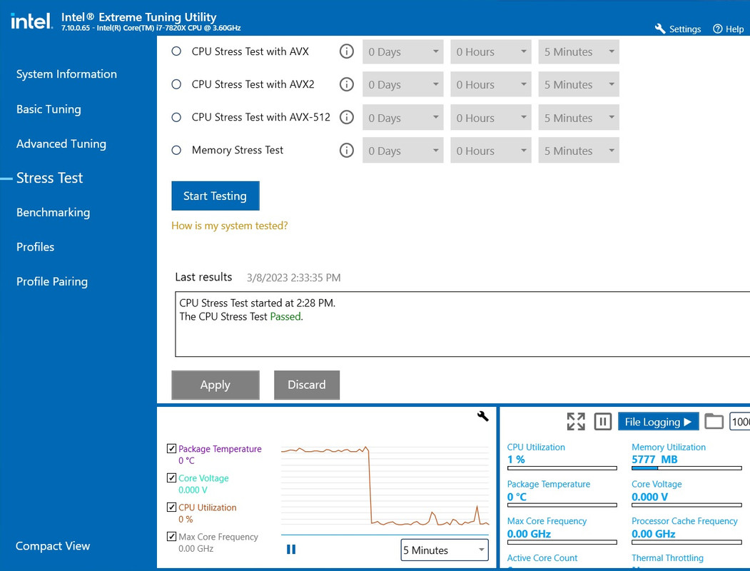

p.s . I tested my CPU with Intel XTU and is passed without problem....so my CPU is OK right?

today i change my thermal degree paste with Arctic Silver 5 ,and now in Prime95 stress test i have 52-54 degree....This paste AS 5 is the best....

Hello, @ghost1
Thank you for the information provided.
Just to understand your last post, what is the issue with those temperatures? They are normal temperatures, as the maximum is 100 degrees as you can see here

Tjunction of 99 degree is a maximum temp. allowed for this processor before fries,and at this temp is not normal and result in thermal protection with restart for sure,but in my knowledge, anything over 75-80 degree is not recommended for ANy processor in this world....because anything over 75 degree is not safe-Throtling.For any proccessor to run Ok,it must be as cold as possible,that's why many people made Delid process for better potential room overclock
