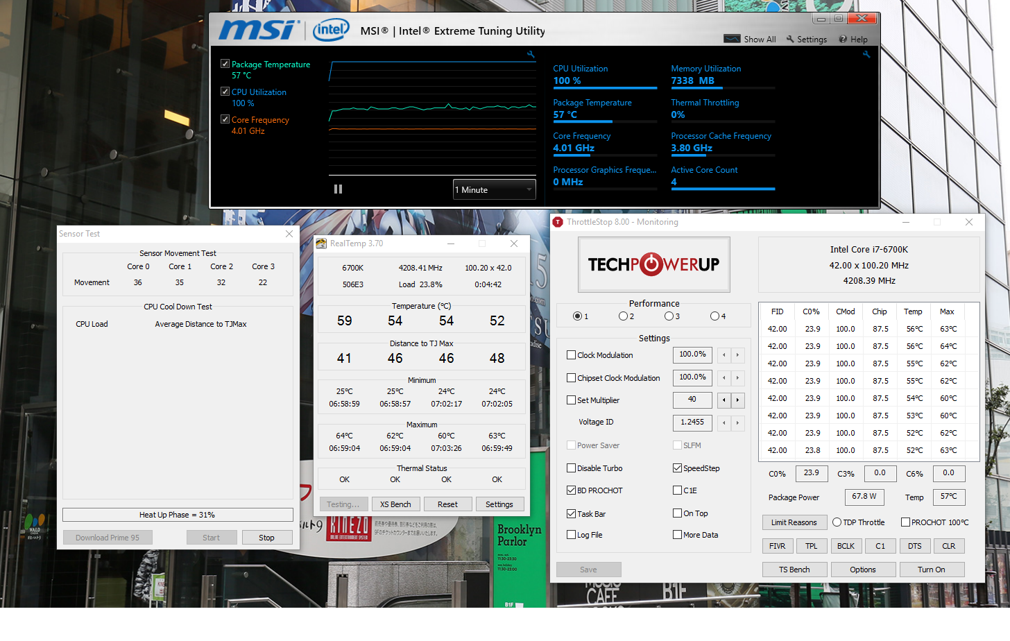

Hello there. I really hope someone can give me an answer so i don't have to worry
Some of the monitoring Program been giving me very strange result.
As i will be doing some overclocking i want to make sure everything is working fine before aporching it.
1. I use Realtemp combine with Prime95 to stress the CPU to find out if my cooling is working OK but it only show 23.9%CPU Load while all the other monitoring program suggest that i am at 100%CPU Load during the stress test (image 1). Some said Realtemp is more accurate and the reason is because my CPU has Clock Modulation Throttling which is shown 87.5 instead of 100.
2. I have ran intel cpu diagnostic tool which does give me a Green Pass with acceptable temperature.
3. HWMonitor show abnormal Clocks- Core# 0-3 speed and sometime it sometimes spike over 10000Mhz ( image 2 show over 5000mhz )
I am running at Stock Speed without any overclocking.

Hi SHKO,
The Intel® Core™ i7-6700k is new and some processor stress tools are not prepare to recognize them properly. It is recommended to run each stress tool alone.
Mike C
