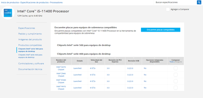

Thank you for your very complete and satisfactory answer, I confirm that my aforementioned "MSI B560" motherboard has the B560 chipset, the "full/exact model" detailed in this link:
https://www.msi.com/Motherboard/MAG-B560-TORPEDO/Specification
Now I understand that I did not choose an incompatible one, because it guided me from this Intel web platform you mentioned:
How to Find Compatible Motherboards for Your Intel® Boxed Desktop Processor
And this is my search for Intel i5-11400 compatibles motherboards, it includes my motherboard menttioned "MSI B560":
Although the B560 chipset is not mentioned on this page as well as the box where the processor comes:
So, my board is compatible with the processor, but do I need to change the BIOS version to run it? Because motherboards' manufacturer MSI gives me this option on their website:
https://www.msi.com/Motherboard/support/MAG-B560-TORPEDO#support-cpu Link / Product Service / Compatibility
This is the option in Intel i5-11400, the zip file:
T

You are correct, the motherboard MSI* MAG B560 Torpedo is compatible with the Intel® Core™ i5-11400 Processor.
Regarding your inquiry about the BIOS version, we understand that the MSI* CPU compatibility list says that the processor is supported since BIOS version 7D15vA0.zip. Checking the BIOS* download link, this BIOS is actually the first BIOS release. This means that that is the lowest BIOS that may come with this motherboard which would still be a supported BIOS.
Just in case, we would recommend that as soon as you build the system, going to the BIOS and checking the BIOS version to confirm it is a supported version (either 7D15vA0 or a newer one as the ones listed in the MSI* download link). If that is the case, you should be fine.
The general recommendation is to keep the system up to date, this includes BIOS. If there are newer BIOS versions available for your system, you may check with MSI* Support for the features, improvements, and fixes included in a specific BIOS version and if they recommend updating to that version.
Note:
We understand that the Intel® Core™ i5-11400 Processor Product Specifications does not list the specific B560 chipset in the section Compatible Products and it just says that the processor is compatible with "Intel® 500 Series Desktop Chipsets" (which includes Intel® B560 Chipset as part of them).
However, the specific chipset is indeed shown as compatible in the Intel® Product Compatibility Tool, in the entry related to this specific motherboard:
Thank very much you for your feedback. For any other inquiries, please don't hesitate to contact us back.
