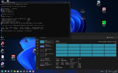

I have an i7 12700k with an Asus Z690-p WiFi mainboard and tere are some problems from the CPU or mainboard (I don't know which is the problem but I beleive that one problem is from the CPU)
I did some stress tests with LinpackWtreme with 2 and 3 cores.
I don't know what is going on but something strange happens.
With 2 p-cores running the performance is higher then with 2 p-cores + 1 e-core and that degrades performance.
With 2 p-cores the result is ~ 141 Gflops with 1175 seconds rutime.
With 2 p-cores + 1 e-core the result is ~ 78 Gflops with 2110 seconds runtime, and I believe it should be higher.
Here are the ss I made:
2 p-cores:
2 p-cores +1 e-core:
The same problem may happen with other programs and instead of having higher performance is lowered
Also if I park the e-cores in Windows and run the program the e-cores in task manager say that are parked but they are still assigned...

Sometimes the system is sluggish and if feels slower then my old i7 6700k, even at boot, and I wanted to find out why and I did the test that I reported in my previous post.
It seems that when is running an app that is using few threads, (in my example 3) split on p-cores and e-cores the performance is dropping to the number of the e-cores is using without counting the p-cores, like p-cores dont exist. The performance should be a sum up from p + e cores, and is not happening when lower number of p + e cores is used, it seems.
If I park the e-cores and run the progam still uses them and performance is decreasing when 3 cores are compared to 2 cores stress test. If I remove all the e-cores from the CPU affinity and I leave only the p-cores the performance is increasing like normally should do.
Also I tested with prime 95 version 30.8 build 15 and when it runs with 12 torture tests everything is fine.
If I run only 3 tests it starts splitting the threads randomly and the PC is working extremply slow and when I move mouse is freezing and moving, freezing and moving, and the CPU is not even fully utilized ...
If is not a software issue I start to think that alder lake CPUs have problems, when they are not fully utilized and when p and e cores are used together, and they were not tested in all running scenarios.

I tested with default bios settings, with Intel fail safe settings, no xmp, and it still doesn't run as it should with 3 threads.
LinpackXtreme has stress test and after each test reports the CPU performance in Gflops and the time that passed after each test.
With 2 threads is finishing the test in about 1100 seconds, and with and about 140 Gflops.
With 3 threads should be faster and with more Gflops, but it finnishes in more then 2000 seconds with half the Gflops (78), because it uses 2 P-cores and 1 E-core.
The program is using the 2 P-cores + 1 E-core and is like is working only on the assigned e-core.
Is like the cores are on different CPUs not on the same one and something is going wrong.
That is the problem, and I think that is a problem with all alderlake CPUs, thats why some programs have the issues they have with the E-cores
The mainboard doesn't give any blinks. The only blinks I get is when is doing memory training and from the power led, because it doesn't have any leds on it.
Maybe is better to make a program to activate and dezactivate e-cores and not using parking. E-cores are still used by windows, even if it shows parked when I put mouse on them.
Parking or disable E-cores is not a good solution for a CPU which should work as a whole not as 2 CPUs. This is a bad implementation.
If I wanted 2 CPUs I would have bought 2 PCs.

I was not enabling or disabling cores. The Intel® Thread Director or OS automatically assigns the cores.
I only tested to see what happens if I make the application use only the p-cores by using CPU affinity and with 3 p-cores running the performance is increased, with 3 cores from which 2 p-cores and 1 e-core the perormance decreases ...
I don't use any CPU or mainboard utility in windows and why should I install XTU ?
I have DDR5 memory and I tested with XMP disabled , default maiboard settings and even at 4000 Mhz and it does the same thing. Is not the memory the fault.
From this page https://www.intel.com/content/www/us/en/support/articles/000088259/processors/intel-core-processors.html
when you set in bios Legacy Game Compatibility Mode to ON in windows when you enable scroll lock in task manager with mouse hovering over e-cores you can see that it show that the cores are parked. That's what I mean by "using parking". I don't know how that core parking should work but is not doing anything. Maybe instead of core parking should disable the e-cores.
Asus representative told me that is Intel problem what it should do and form what I see is doing nothing.
I'm not new to this forum, I had many posts in the GPU part of the CPU when I bought i7 6700k, and many things were fixed but my account was deleted and I even don't know why.
I was expecting for things to be better on this new CPU but unfortunately I'm disappointed. I feel again like beta testing on my own money.

In reality no one is using a benchmark or another CPU utility. They are used to check how CPU behaves in certain situations or to test the CPU.
Imagine that the so called 3rd party app is an old game or app and at a certain point it uses 2 p-cores and 1 e-core. It means that it will run slower then if it was running with 2 p-cores, because the time used to solve a problem for 2 p-cores + 1 e-core is the same as it was running the same problem with only 1 p-core. When running 3 threads on 3 p-cores the time is 3 times lower.
I'm not talking about Gflops now, but about time.
That program, LinpackXreme is doing a math problem and you can select how many threads to use and it shows the time it was finished and the computation power of the threads used.
Anyway if you don't care about it and try again to make me run XTU which is not able to run for stress test or benchmark a number of threads that I select, I will give up and next CPU will be from competitor.
I want a CPU that can run any app and with increase performance, even with lower count of cores used, not hindered because it has some cores that are not performing like the others or they bother the other cores to work correctly.

I made a screenshot and a video (attached). The "tool" is available at this link : https://www.techpowerup.com/download/linpack-xtreme/
