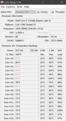

i7 13700k with cheap waterblock but double 420's radiators -> easily 100*C
with Heatkiller 4 pro and same radiators -> 85~90*C , once a while it touches 100*C , and that is how it looks like:
To put it in another words, my setup can never continuously work at 100% CPU load, the die of the CPU is too small and can not be cooled efficiently enough. For that reason i use XTU and limit the power to 200W , else i think the CPU will melt one day.
But, 85*C is normal for those CPUs it seems.

idle of more than 10*C over the room temperature is not normal, bcoz your CPU should not take more than 6~15Watts in that state and that in high performance profile. Mine stays at 7*C over room temperature.
And yes, as seen on the screen, on full load ot easily did hit 100*C

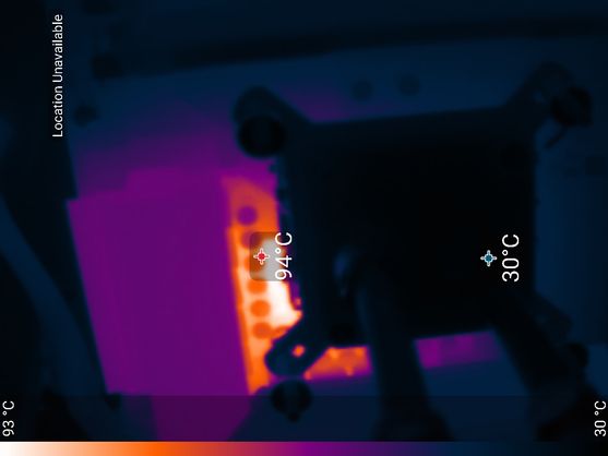

size of the radiator in this case means nothing, bcoz the die of the CPU is tiny considering it does 250W.
I got here twin EK-CoolStream 420 and even with fans on full power the CPU hits 100*C....that is bcoz the water block on the CPU can not transfer enough heat onto the water.
That being said, i can assure you , that the i7 13700k can run continuously triggering the thermal throttling and stay at 100*C all the time without being damaged....i did that for about 70hrs straight.
The only thing i was not sure about is the motherboard, bcoz the space between the CPU and the top part of VRM was hitting over 90*C....it was the PCB that had such temperature on the Gigabyte B790 Gaming X motherboard, that motherboard is cheap and does not allow overclocking - for obvious reasons.
As can be seen on the thermal image, the 30*C is the water coming back from the radiators, yes it's just 30*C, but the CPU is at ~100*C
and the 94*C above the CPU is the PCB, it has same temperature on both sides....the darker round spots are the capacitors and teh closer the PCB is to the VRM heatsink, the lower teh temperature.
I hope your motherboard is better than mine lol
