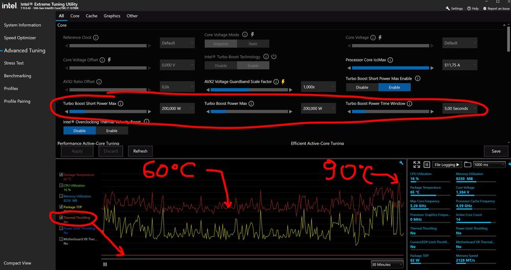

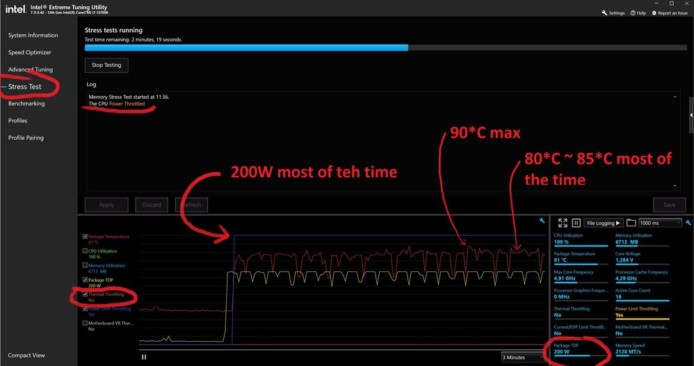

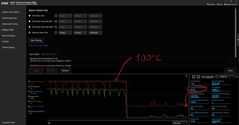

So, here is what i did, i changed the power limit to various values.
At 200W it only hits thermal throttling, when i run some tests (on the left in the XTU window you can see "Stress tests" if i run the memory test for like one hour, the thermal throttling will occur once a while, bcoz teh CPU will use 200W all the time, and on no power limit it will hit the thermal throttling continously)
here an example, limit at 200W no thermal throttling but continuos power limit throttling:
maybe i should change colours lol bcoz red is for temperature and orange for thermal throttling....looks very similar

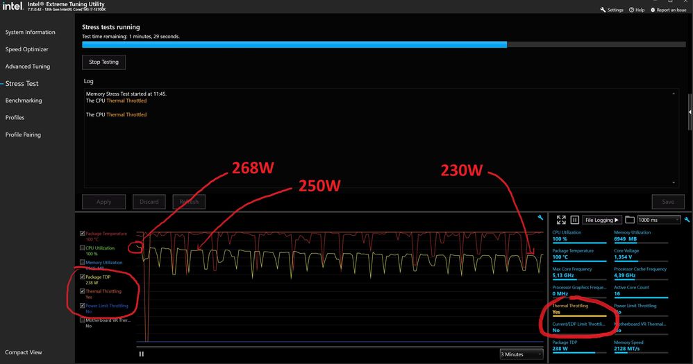

...and without power limit, at the beginning it hit almost 270W since i let it sit in idle for few minutes and everything was cold...
you can see as the CPU got warmer on average and kept close to 100*C, the power was automatically decreased with time, started at almost 270W and then dropped to some 230W average.....not cold enough for the CPU to use full power all the time.
and when i stop the test, the temperature spikes down right away, if that does not happen on your side, and temperature seems to decrease slower, then i would say that you have a problem:
In other words, that is how i concluded that despite good cooling power, the cooling power does not reach the CPU bcoz of teh water block or bcoz of the tiny CPU die.....could be both.
I wish someone would post all that and i wouldn't have to test it myself, but no one did, they just said the CPU will hit 100*C very often.
Summary, if your setup behaves similar to mine, then the CPU and water block are stuck together quite well.
Of course, at 230W my double radiators do contribute to slightly better cooling....so you may end up with a slightly lower power if you run the test longer OR if your room temperature is way higher than 21*C.
Hope that helps you answer all your questions.

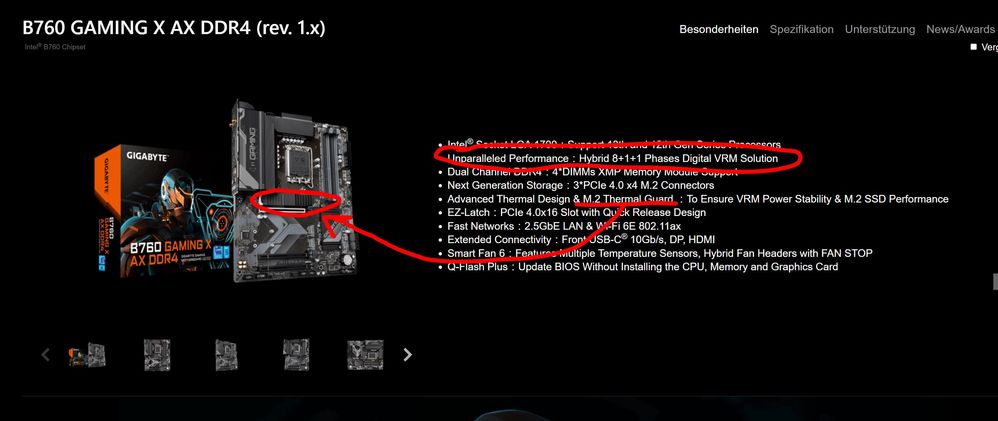

And just now i took a look at the B760 and B790 specs, mine is by the way DD4, since i had 16gigs of DDR4 RAM....anyway, the difference is as you said the ability to overclock, and by far the 790 can do it and it was made for it.

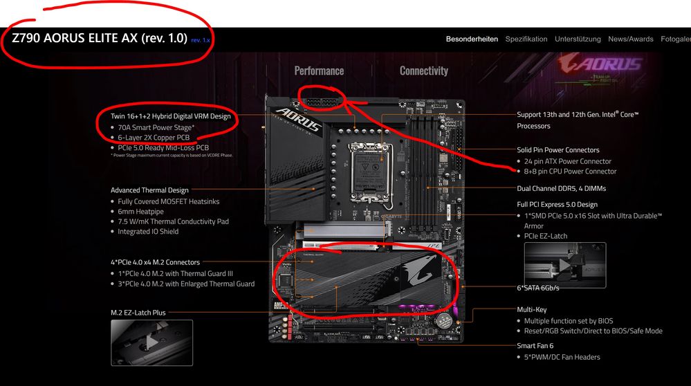

It has double power supply for the CPU, and they claim it has "6layer 2x copper" whatever that means, i guess it's fine if its multiple layers of copper, maybe the PCB on there is not hitting 90*C as is does on the B760.
And so, the below B760 has just 8+1+1 phases VRM , this tells you how it switches the power, obviously the CPU needs a constant power supply, and the more phases the more stable it should be.
The board has only one M2 SSD heatsink "thermal guard"
now teh B790 says right away that it can take 70Amps, ....@5V  that would make it to 350Watts....interesting, i saw boards , but really expensive that said they could take 90Amps , with  80Amps is the starting current and almost good enough for welding with a 1.5~2mm wire except the voltage here is not 25Volts.
Yea, then there is that massive heatsink for M2 SSDs and one small just like on the B760, plus like i mentioned, double power supply/connector for the CPU.
I would be not surprised, if this board can take 500W easily without going off with some smoke.
More copper = thicker tracks on the PCB and the power delivered to the CPU is more stable as well as the board takes no damage. I guess that is why it is more expensive.

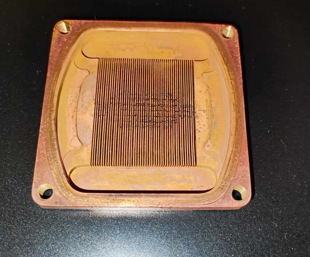

Knowing that water cooling may bring also unwanted drawbacks, such as junk in the liquid, it is possible, that the jet plate of teh water block, is full of such junk and no liquid gets through.
There seem to be no video on disasembling the unit, so you would be on your own.
if there is some junk, you would have to  flush it the loop with destilled water few times, let it run, flush again....., and also do not add any fancy ani-corrosion additives, bcoz those have a not so long lifespan and will degrade resulting in more junk in the loop....swapping the destilled water once few month would be best solution....and would cost some time.
If you decide to open the loop to seeif the liquid is contaminated, and if it is, then you can use a tooth brush and literally toothpase to clean the jet plate.
Yours will not look like this, but will be similar, and if its also made of copper, it will have corrosion, just like this one in the middle of it where the ater had most pressure:

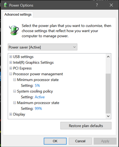

KrissyG
新貢獻者 II
22,688 檢視
if you feel fancy, you can setup the 'Power saver' profile in the power options of windows, just like i did, only important is that the 'maximum state' is less than 100%, that will result in CPU not clocking higher than 2,5GHz and a max TDP of some 50 Watts.
XTU is not limit the power here, windows OS is:
