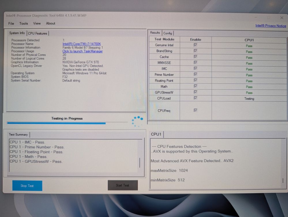

Now, I just ran Intel Processor Diagnostic Tool to check my 14700K for the first time, and it keeps freezing at CPULoad test with AVX2.
Do you think my CPU has instability issue?
(Please ignore the different GPU info in the screenshot because it is a spare GPU and I have not received 9070 XT yet from RMA center.)

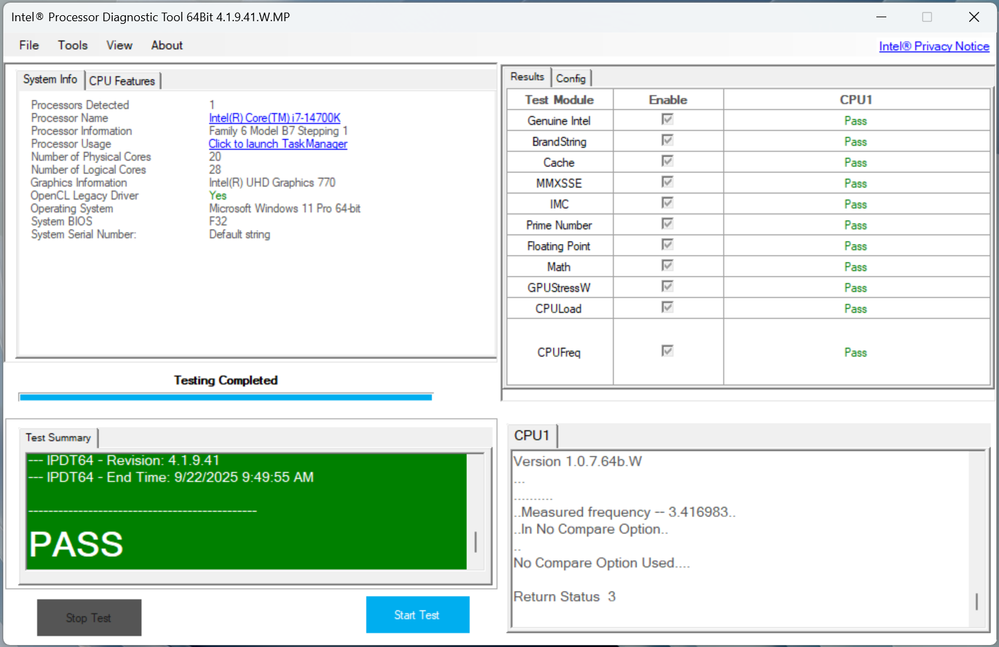

However, I took out the spare GPU NVIDIA GTX 970 and re-run IPDT, then surprisingly I got PASS. This is very weird result, but it is.
Also I generated a text file from SSU and attached.

Now I no longer experience the issue. Thanks for the support.
