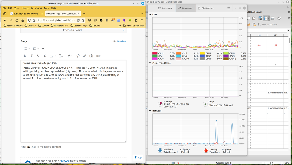

Intel© Core™ i7-8700K CPU @ 3.70GHz × 6cores     This has 12 CPU showing in system settings dialogue.   I run spreadsheet (big ones).  No matter what I do they always seem to be running just one CPU at 100% and the rest barely do any thing just running at around 1 to 2% sometimes will go up to 4 to 8% in another CPU.
You see from image that system monitor shows various readings but when the spreadsheet is running alone it is as I stated above.  All those CPU's and only one is maxed out.  Spreadsheet slow (i.e. 20 minutes to save after editing).  Memory usage seems to be stuck at 5 to 6 Gig
Is there something I can do about this to make the computer /Intel chip to use far more of the resources available ??
The screenshots have loaded with 2nd image first - I have just started spreadsheet inserting a new blank column into columns already in spreadsheet.  3rd image is same as 2nd image but slightly further on in the column insertion process.
So saving takes ages and also editing as explained above

I downloaded the ssu file unfortunately I get a response dialogue that says this archive type is not supported in my system.  I am running Linux Mint, which I keep fully up to date.  The details of all of that are in the previous data I have sent you.  Why it won't run is probably because of me.  If i click /double click on a file I expect it to open or ask me for my authentication.  I have no knowledge of what to do if it does not run.
I am running LibreOffice Calc in Linux Mint.  I do not run any other type of files except in LibreOffice files.
My system can freeze or crash with some of my spreadsheets because they are "massive".   As an example - if I load "System Monitor" program I can watch this and often have.  While only one thread seems to be used to its maximum;  the others just small or minute percentages of activity - the system starts to use up all memory (33.6 Gigb) and then goes on to use the Swap file space (64Gigb) towards the 'end' it runs away to 100% and then yes it crashes.

Thanks for your patience. Since this is happening in a Linux environment, I recommend you check this issue with the Linux support team. This is because our support for Linux is limited.
Also, the size of spreadsheets is huge and that could cause performance or freezing to other systems as well, not saying this is normal behavior but definitively will be affected due to the size of the files. if is not happening on other files or with other apps I would think is more related to the file size.

  1. The O/S (the Linux Kernel) is responsible for *all* decisions regarding when and how a processor's threads are going to be utilized.
  2. It is LibreOffice Calc that is responsible for *all* decisions regarding how it will utilize multi-threading to optimize large workloads.
I am not interested in any rebuttal from you - at least not until you have discussed this issue with the Linux Kernel and LibreOffice teams.
