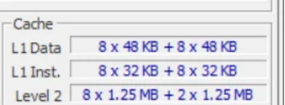

I bought this CPU and built my PC this April. Today I was playing around and found out that on ark intel that 12900KF has 14MB of L2 Cache. A quick check on task manager shows mine has 12.5MB
Then I checked on Intel Processor Identification Utility and HWiNFO for reassurance
Here you can see my e-core's L1 is 8x32+8x48, though various sources (e.g. a user on reddit), it should have been 8x64+8x32.
This is also the case for e-core's L2, it is 2x1.25MB instead of 2x2MB. That means 8x1.25+2x1.25 = 12.5MB, so I am missing 1.5MB of L2.

I have reinstalled your version of Chipset Driver, Management Engine Interface and Serial IO Software. After that I updated the BIOS to 1820. Unfortunately, the problem still persists on the newest version of Windows 10, every tools and even Windows still reported the wrong info. I tried CPU-Z and it was the case too.
CPU-Z report shows wrong L1, L2 cache

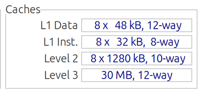

Therefore, I went to Ubuntu 24 to check. I tried lscpu, which showed the correct config
lscpu command
Though people said lscpu is not reliable enough, so i tried dmidecode, CPU-X (A linux CPU-Z version) and lstopo
CPU-X performance cores L1, L2
CPU-X efficiency cores L1, L2
lstopo's graphical interface
They also reported the right L1 and L2.
I should have told I use Windows 10 beforehand, I heard it has some weird bugs on big little architecture but not this weird cache bug.
