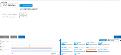

Today when I started my PC, it was incredibly slow. When I looked in task manager I saw it was only using 0.39Ghz.
XTU says the same.
This is what XTU says, I've also run the Intel Processor Diagnostic, and it passed that.
I use this computer for work and I'm a bit lost at what to do now.
Looking forward to hearing from anyone.

XTU is also telling you that your processor is being Current/EDP limit throttled. This typically occurs with a misconfigured BIOS or failure occurring in the power delivery circuitry. Are you seeing the same issue with the laptop running on A/C and Battery power?
