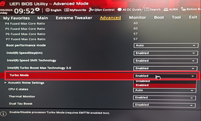

Hey @Stryker619
Thanks for the hint about Turbo Mode, super useful!
Could you provide a screen cap or the path to where the Turbo Mode option is in the Asus Bios, pls ?
Since I switched from 13900K to 14900K, my PC is much more stable with my Asus ROG Z790 Hero.
But I still have some rare but random crashes when slicing objects with my 3D slicer (Bambu Studio), and some occasionnal crashes with Chrome tabs
I believe @Stryker619 specifically mentioned "Turbo Mode" :
I found it here : Advanced menu > CPU Configuration > CPU – Power Management Control > Switch "Turbo Mode" setting to "Disable"
