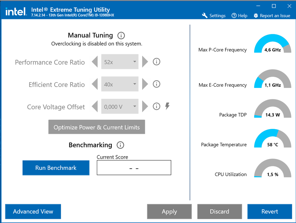

Well, as you can see I cannot use Intel XTU on my laptop sadly
March1111
5,000 Views
Oh that's odd. Can you try Throttlestop and see if you're able to use it? Just trying another chance.
If you can't use any of these softwares you can go and unhide that power plan option, CPU Max. Frequency limiting option, you could easily use Turbo Boost but still remain at stable levels.
