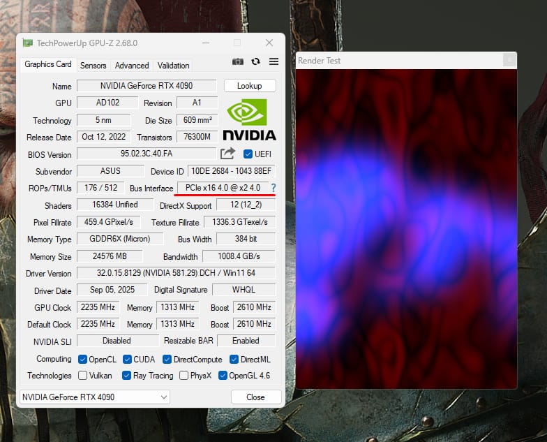

i9-14900K PCIe lanes training issue – GPU stuck at x2
I believe my Intel Core i9-14900K may have an issue with the PCIe controller or lane training.
My GPU (ASUS ROG Strix GeForce RTX 4090) is detected as:
PCIe x16 4.0 @ x2 4.0 (even using render stress test, and sometime x1)
I also tested using a RTX 5060 and same issues appears.
This is confirmed both in GPU-Z and in the motherboard BIOS, which reports:
PCIEX16(G5): x2
So the problem appears before the OS loads.

Because the issue persists across different GPUs and a brand new motherboard, it seems the CPU may be failing to train all PCIe lanes.
Has anyone seen a similar issue with Raptor Lake / 14900K PCIe lane training?

Hi guys!
I’d like to provide an update regarding this issue.
The CPU RMA was approved, and I received the replacement unit at the beginning of April. The processor has been installed and in use for some time now.
I’m happy to report that the problem has been completely resolved. The PCIe lane training is now working correctly, with the GPU properly negotiating at x16 as expected. No further issues were observed, either in BIOS or under load.
This confirms that the original CPU was indeed the root cause of the problem.
