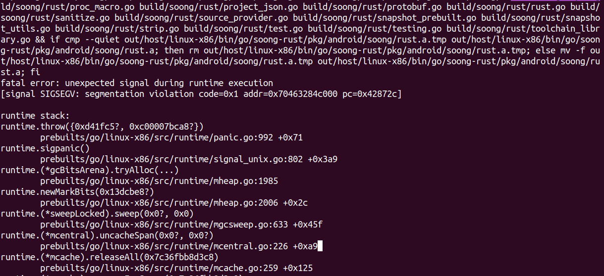

Hello, got constant crash with build AOSP 13 at intel 285k and 265k.
OS: Ubuntu 22
kernel: 6.8.0-49
command for download and build:
echo "start download $(date)" && \
repo init --depth=1 --no-tags --current-branch -u https://android.googlesource.com/platform/manifest -b android-13.0.0_r83 && \
repo sync --current-branch --no-clone-bundle --no-tags && \
echo "start building $(date)" && \
rm -rf out &&\
source build/envsetup.sh && \
lunch aosp_arm64-eng && \
export LC_ALL=C && \
sed -i 's#!/usr/bin/python.*#!/usr/bin/python2#g' device/generic/goldfish/tools/mk_combined_img.py && \
make -j$(nproc --all)
may be any1 know how to fix it ?
(same task on 13900k with the same memory working without any problems)

Hello, happy new year !
> May I know if the processor is working fine before?
all fine, AOSP 10 compiling without problems before and after problem with AOSP 13.
no thermal throttling, temps are ok
> How did the issue happen?
just run compilation again and again, after I got a problem I go to seller of CPU and he found total different hardare set with MSI MB with water cooling and 265k, I tested here too - with same result so problem definitely not in my hardware, may be in all intel CPU generation totally.
>Are there any changes on the system before you encounter this issue?
no
>What are the troubleshooting steps you already tried?
I got instability firstly with 14600k before, and simply solved it by lowering down CPU freq.
but here it not helping, tried low down CPU freq, RAM freq - no difference
checked RAM - no errors found
stress-ng -- cpu 24, compile AOSP 10 with j24 - all ok
>May I know the make and model of your motherboard?
ASUS TUF GAMING Z890-PLUS WIFI
with latest BIOS
RAM: UD5-6800 96 Gb.
also same RAM with 13900k, 14900k before - all ok with compile AOSP 13.

are you mean that arrow lake not support the same instructions as 13900, 14900 because not have problems with them ?
Hello, thank you for info.
trying to access link you provided, got:
User account '**bleep**@outlook.com' from identity provider 'live.com' does not exist in tenant 'Intel Corporation' and cannot access the application, can you provide another link ?
I got random crash with arrow lake, but time-to-time AOSP 13 build is success (rarelly) this mean that all instructions are supported but there is instability in Arrow Lake CPU ?
Or you mean, that arrow lake not supporting same instructions set as 13900, 14900, that building without problems ?
Have you tried command for build that I provided ?
Are you contacted and raised this question to CPU technical support who can analyze CPU instability and they did tests ?
