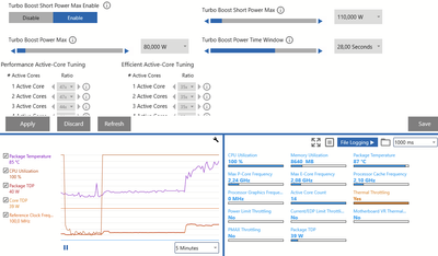

I render using Vray for 3ds Max and my company got me a new PC which is ASUS ExpertCenter D9 Mini Tower D901MDR, with Intel Core i9-14900 Processor, the CPU is running at 5 ghz clock speed but when I start any render it clocks down to 2.7 ghz, I tried a lot of stuff in BIOS but nothing really helped, I even thought it might be something related to Vray so I ran Cinebench and got the same issue.. is this normal ?

I've run a benchmark test using Intel Extreme Tuning Utility and found that my CPU is experiencing power limit throttling during the test.
Additionally, the benchmark score I received was 8880 marks, which seems lower than what this CPU should typically achieve. I also couldn't find any options in the BIOS to change or modify the power limit throttling.

PTwr
3,318 Views
Sustained max boost requires sufficient power delivery, sufficient cooling, and no stupid bios/os power profile kneecapping CPU to keep thermals in check in case that should never be used for such beast of a chip.
One easy test is to boot some Linux from Live-USB, and run stress test from there. That would tell you if issue is in hardware/bios or in system/software.
While in XTU you can check Turbo Boost power max and its Time Window. Those values should be tweakable on every chip, and you can create custom power profiles for your usecases.
Of course have in mind that tweaking it up will strain probably inadequate cooling of your machine, assuming its motherboard power delivery wasn't built for much weaker CPU in the first place.
Additionally, you can switch task manager CPU graph to Logical Processors to spot Windows Power Plan limits which can affect Performance and Efficiency cores differently, such settings can be applied/supplied by OEM to hide insufficient cooling. And there are also hidden "overlays" and "events" which can apply even more annoying limits.
Here's how it looks with artificially limited wattage through XTU, hardware/bios wattage limits should look similarly - clocks stays low despite low temp
Here's how it looks like with no software limits applied, and hardware/bios limits matched well with cooling capacity - clocks stay high despite laptop turning into hand warmer
And here's how silly it looks when you you apply software limits:
(Frequency limit is simplest setting there, there are dozens other options there which affect CPU)
If during stress test XTU says 100%, but in task manager there are cores which are clearly well bellow 100%, you might be afflicted with stupid power plan.
For example, on this laptop Windows "Best Efficiency" Power Plan Overlay kneecaps Efficiency cores to 50%, but Performance cores stay at 100%...
