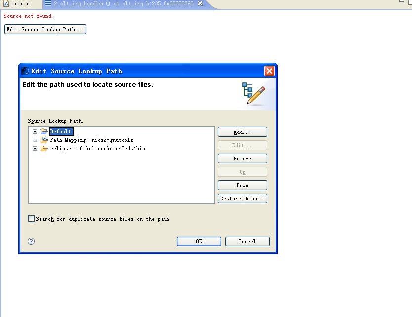

Dear billa:
My board can ping it,But I meet another qusetion,I want to use the udp protocol to send and receive message!Unfortunately I can't send.I want to use the board acts as client and send the message to computer.maybe my code lose someting important,could you help me check it?
waiting for your reply,thank you very much!
here is my code:

Add Include Path ${workspace_loc:/altera.components/Nios II Software Packages/altera_iniche/UCOSII/inc}
I cannot unstand why? this example use UC/OS???
Altera_Forum
3,549 Views
Billa I meet this problem,can anyone help me?thanks

HI
I met this problem,how can i solved?can you give me some advices?which path may i chose?
