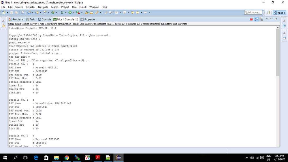

I have been trying to implement NIOS II simple socket server for Cyclone V GT from the reference design from the link: https://fpgacloud.intel.com/devstore/platform/16.0.0/Standard/nios-ii-simple-socket-server-ethernet-example-for-cvgt/
We are trying to use static IP instead of DHCP client where the ethernet port of FPGA is connected to the CPU port along with the JTAG. We are getting the following display on the NIOS console:
InterNiche Portable TCP/IP, v3.1
Copyright 1996-2008 by InterNiche Technologies. All rights reserved.
altera_eth_tse_init 0
prep_tse_mac 0
Your Ethernet MAC address is 00:07:ed:ff:e2:d0
Static IP Address is 192.168.1.234
prepped 1 interface, initializing...
tse_mac_init 0
 speed : 1
 duplex : 1
 result : 5

The second Auto Negotiation is failing. We have tried to vary the speeds and do all sorts of experiments but in vain. Kindly Help!!

Hello Eliath,
So, Initially, we tried using the reference design for 16.0 in Quartus 16.0. We got many errors as shown in the screenshot. 16.0 errors.png
When we tried the same reference design in later versions of Quartus i.e. 17.1 and 18.1, some of the errors have been reduced and other errors have appeared related to SGDMA IP used in the ethernet system qsys. The ELF file was not generated. I am attaching the screenshot.17.1_problems.png
So, we got an assistance from a Field Applications Engineer from Intel, where he gave us a new project in which the SGDMA was removed and replaced by MSGDMA. By this, the ELF file was generated. But when we are trying to establish the communication, AUTO NEGOTIATION FAILED error is popping up. I am attaching a screenshot for this.Auto_Neg_1.pngAuto_neg_2.png
Even the reference design does not contain the required main sdc file i.e niosii_ethernet_standard_5CGTFD9E.sdc file to do the timing analysis. I feel that the design present in the website needs a major overhaul to make it working. Kindly help us. We are stuck with this issue for the past 2 months.

                      Thank you for the fix that you have suggested regarding the name mismatch in the TSE_0. It worked. In the NIOS console, I was being asked to provide the 9 digit serial number present at the back of my board (refer to the screenshot). Is this normal? Because I did not come across this pop up when I was working with the reference design present in the website. Kindly guide us. @Eliath_G_Intel Screenshot (43).png
APaga1
初心者
2,966件の閲覧回数
Hello Eliath,
                      In one of the documents present in the website for NIOS II Simple socket server, it was mentioned that in case of issues related to MAC address, we can try typing "255255248".
I have typed that address and it seemed to be working. In fact, any non zero 9-digit address seems to be working. So It shows that the Simple socket server is listening in port no.30 as shown in the screenshot.
But now, when I am trying to open a Telnet server with the IP address 192.168.1.234 and port 30, the connection is not established. I've even tried with 192.168.1.1 but no success.Screenshot (45).png
Kindly help.

Hello Eliath @Eliath_G_Intel ,
                     Thank you for your support. We have observed that the auto negotiation is passing at 1G speed and the naming conventions of TSE are according to what it is suggested in the KDB that you have sent. But unfortunately, the ethernet link is still not up. We are getting the below message in the NIOS console at the end:
Simple Socket Server starting up
[sss_task] Simple Socket Server listening on port 30
Created "simple socket server" task (Prio: 4)
But still we could not establish a telnet session with IP: 192.168.1.234 and port 30. We are hardware engineers and we are finding it difficult to debug the software portion of the simple socket server. Can you please explain what can be a way to progress further? Thank You!
